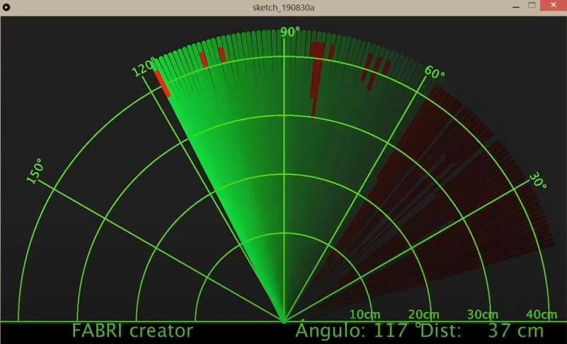

Remote javascript application monitoring with STM32F746-DISCO
Hi, I'd like to use a code from javascript in the STM32F746 DISCO. It's a radar that receives data from an ultrasonic sensor. The code for the radar was made using processing and I want to show it in the STM screen but I got no idea.
Here is the code from javascript and a view of the radar.

Hello @ferdlf ,
That looks like a fun project to do!
You did not ask a question, I assume you want to know how to start using TouchGFX to be able to display your radar on a screen.
Unfortunately it is not possible to run JS code on embedded systems (ex: microcontroller) but it is very easy to do it using TouchGFX.
I quickly put together a copy of your radar (without the sensor that I don't have).
I used the same board that you own so you can flash this project directly from Designer to see it on your screen.
If you are new to TouchGFX make sure to look at our documentation :
For your project I think you will need to look at :
  • the MVP model to be able to fetch the data of your sensor
  • how to use wildcards to display variables (see my example)
  • how to drag a line (see my example)
  • how to use the handleTickEvent function that is called 60 times per second (see my example)
