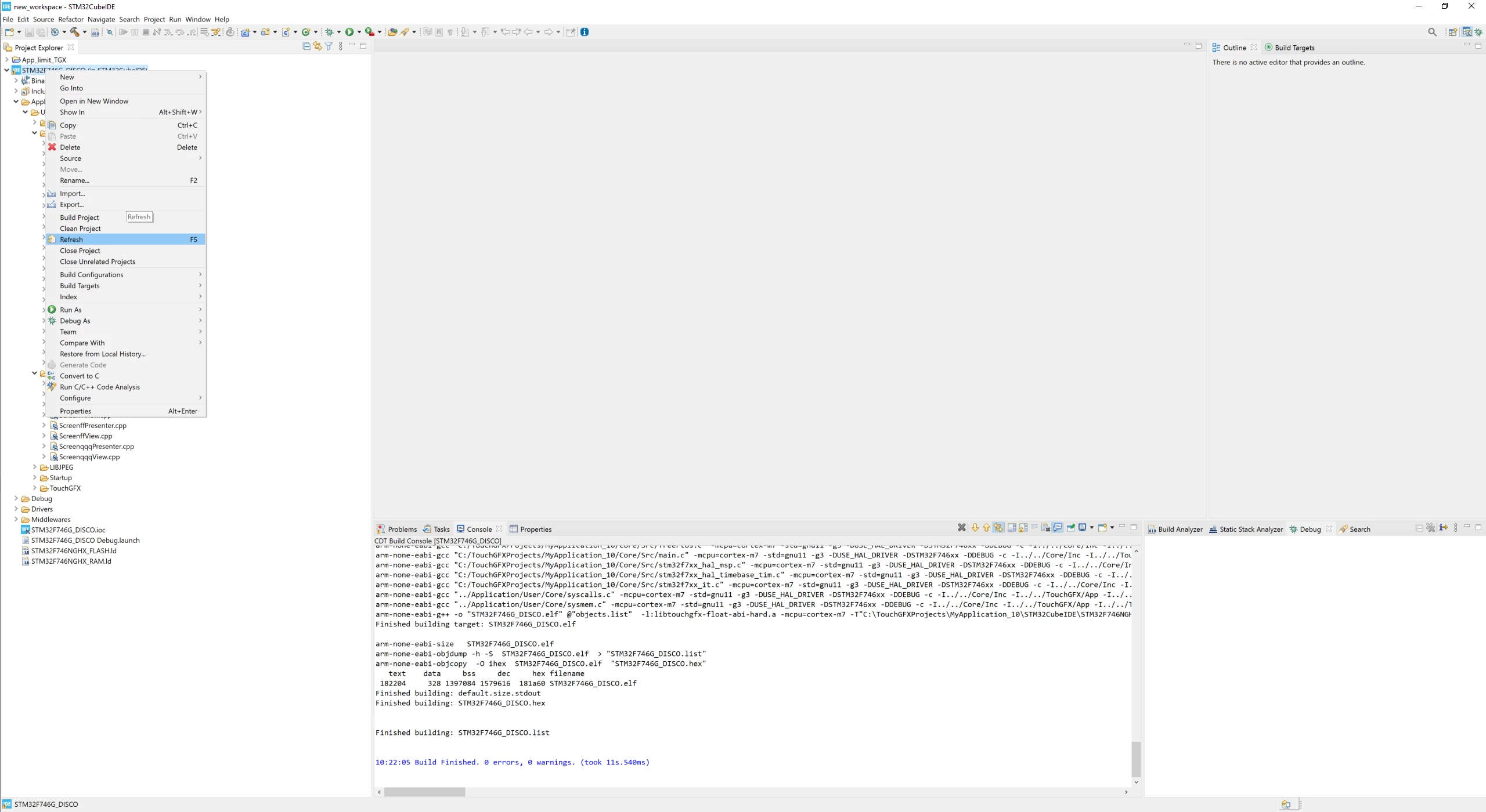

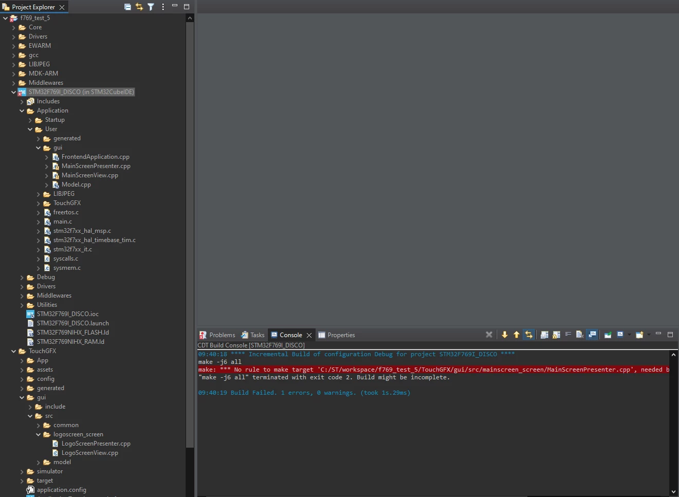

When you mentioned if I refreshed the project I thought I already did so I did some more testing and got what I think is some strange behavior, maybe you can give some clarity, here are the steps I am taking.
Using IDE 1.10.1 and Designer 4.20
  1. Create a project with the designer, default project with no modifications and generate the code.
  2. Import to CubeIDE with "Projects from Folder or Archive" selecting the top directory from the Designer project, then I have the project with the CubeIDE project nested inside.
  3. Build first time and works fine.
  4. In Designer modify the name of Screen1 to MainScreen and generate the code
  5. Then build with the IDE without refreshing, the project is updated with the new file names and builds fine.
  6. In Designer modify the name of MainScreen to LogoScreen and generate the code
  7. In the IDE refresh the top project before building
  8. Then when I build the files are not updated with the new names and doesn't build anymore,
At this point I have not been able to update the project correctly anymore.
Should I import the projects into the IDE using a different approach?
Also noticed that it's not possible to have two projects for the same board at the same time in the IDE, is this maybe related to the Designer always using the name of the board for the project name?

Did you previously generate code for the correct Toolchain in STM32CubeMX ?
If not, open your .ioc file in CubeMX, go to the "Project Manager" tab. Then select STM32CubeIDE in "Toolchain / IDE" option box and press Generate code.
For the project importation, you could also simply double click on the .project file inside the STM32CubeIDE folder. Please try that to see if there is a difference between the two ways of opening a project.
And yes, in CubeIDE, you cannot open two project with the same name in the same workspace, so you either have to open a new workspace or delete the previous project.
