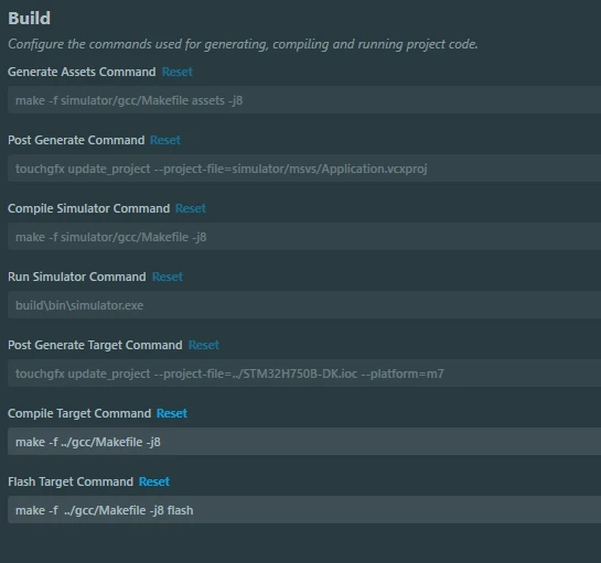

I am getting the following code error. The program build successfully in the simulator but when I try 'Run Target' it fails.
I use the following Build settings. And the detail log is below.0690X00000D8EBQQA3.png

This is line 278 and 279 from the Makefile
_flash_:
	@$(st_stm32cube_programmer) -c port=SWD -d $(binary_output_path)/target.hex -el $(st_stm32cube_external_loader) -hardRst
And this is line 38 -50 of the Makefile
board_name := STM32H750B-DK
platform := cortex_m7
cpp_compiler_options_local := -DUSE_HAL_DRIVER -DSTM32H750xx -DVECT_TAB_QSPI
c_compiler_options_local := -DUSE_HAL_DRIVER -DSTM32H750xx -DVECT_TAB_QSPI
.PHONY: all clean assets flash intflash
all: $(filter clean,$(MAKECMDGOALS))
all clean assets:
	@cd "$(application_path)" && $(MAKE) -r -f $(makefile_name) -s $(MFLAGS) _$@_
flash intflash: all

SOLUTION: I started a session with the wrong discovery board. It was looking for DSTM32H750 files but I have the STM32F7508-DISCO board.
