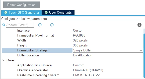

<TouchGFX configuration in ioc file>

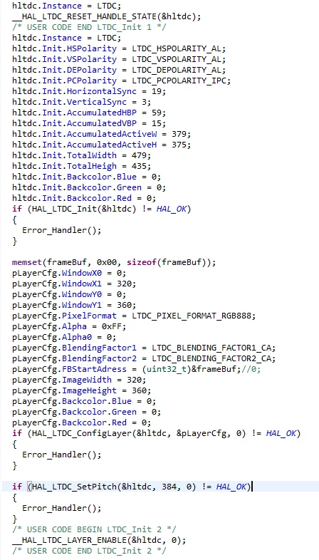

0693W000007EKmLQAW.png<MX_LTDC_INIT() function in main.c file>

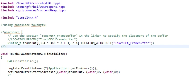

0693W000007EKmQQAW.png<TouchGFXGeneratedHAL.cpp file - for buffer declaration point>

I see primary trouble , that you set Custom drivers. When you use DSI with full framebuffer, you need set LTDC not Custom.

  1. Set Display Interface from Custom to Parallel RGB(LTDC) as MM..1 mentioned.(Thanks again MM..1 for mentioning it ! )
  2. Set Correct Framebuffer Width in TouchGFXHAL.cpp file.
As I was using the original version from ​STM32L4R9I EVAL board, it was defined based on GFXMMU dependent buffer width(3072/2).
The definition goes like BSP_LCD_IMAGE_WIDTH -> GUI_FRAME_BUFFER_WIDTH -> FRAME_BUFFER_WIDTH, finally.
After correcting the width as the one considering DMA2D transfer width, I can see outputs from TouchGFX delivered by DMA2D finally.
