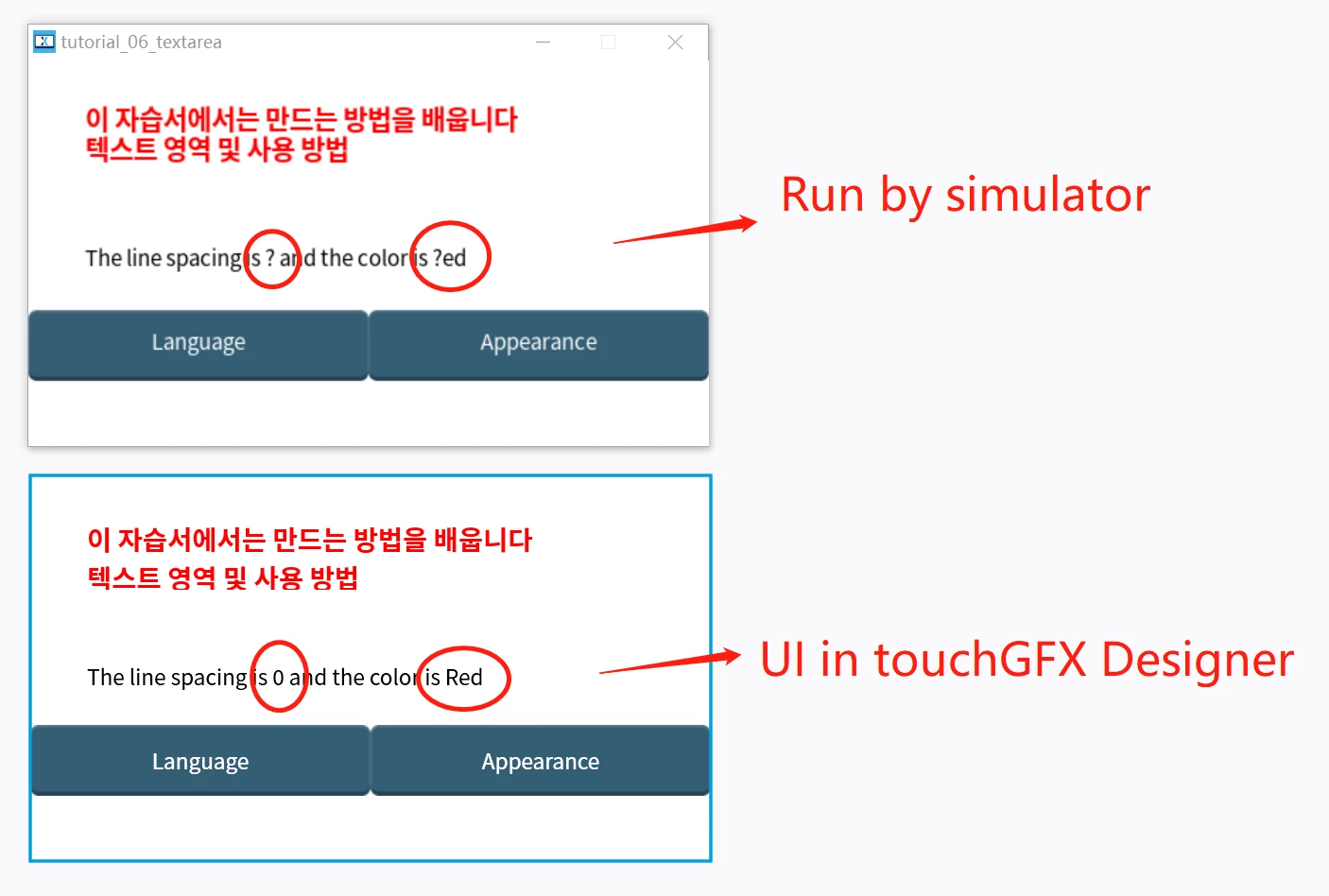

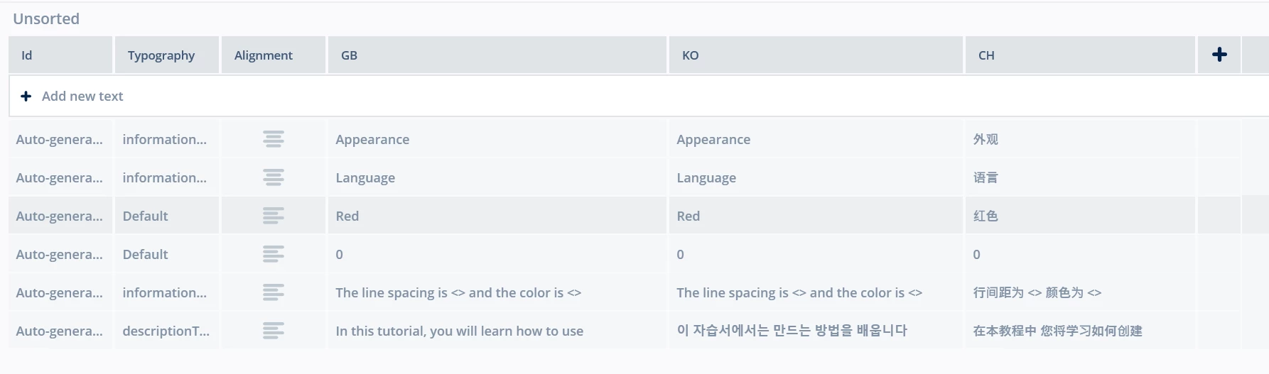

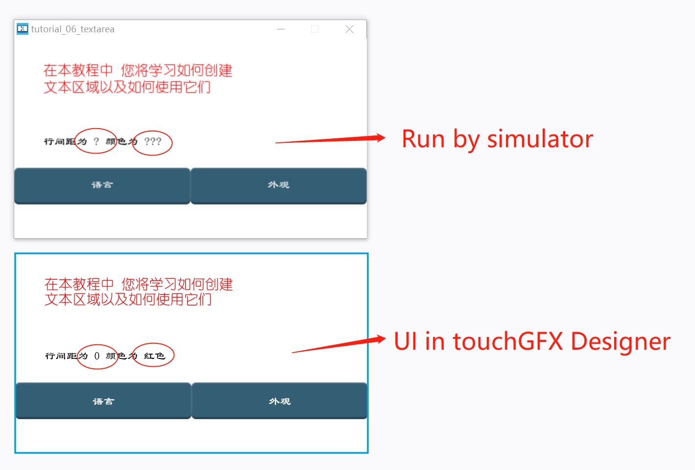

Question about touchGFX tutarial.
I am learning touchGFX by document. Almostly, I have no question, but in tutarial6(https://support.touchgfx.com/4.21/docs/tutorials/tutorial-06/tutorial-06-part-1), I have some issue as below, there seems some characters can NOT display normally at wildcard mode.

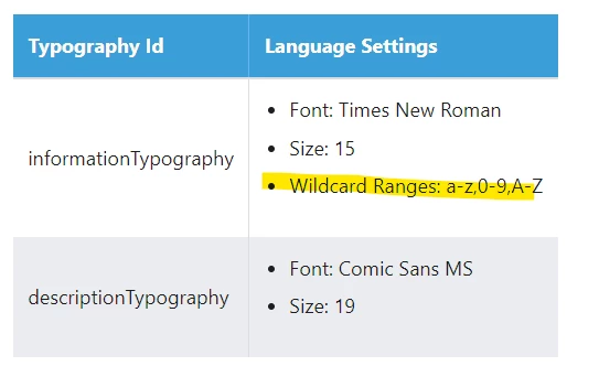

Hello Junde,
You need to set the wildcard characters or the wildcard range in order to make it work :)
In tutorial 6, you'll notice that the range "a-z,0-9,A-Z" is set to be able to display these characters in a wildcard.

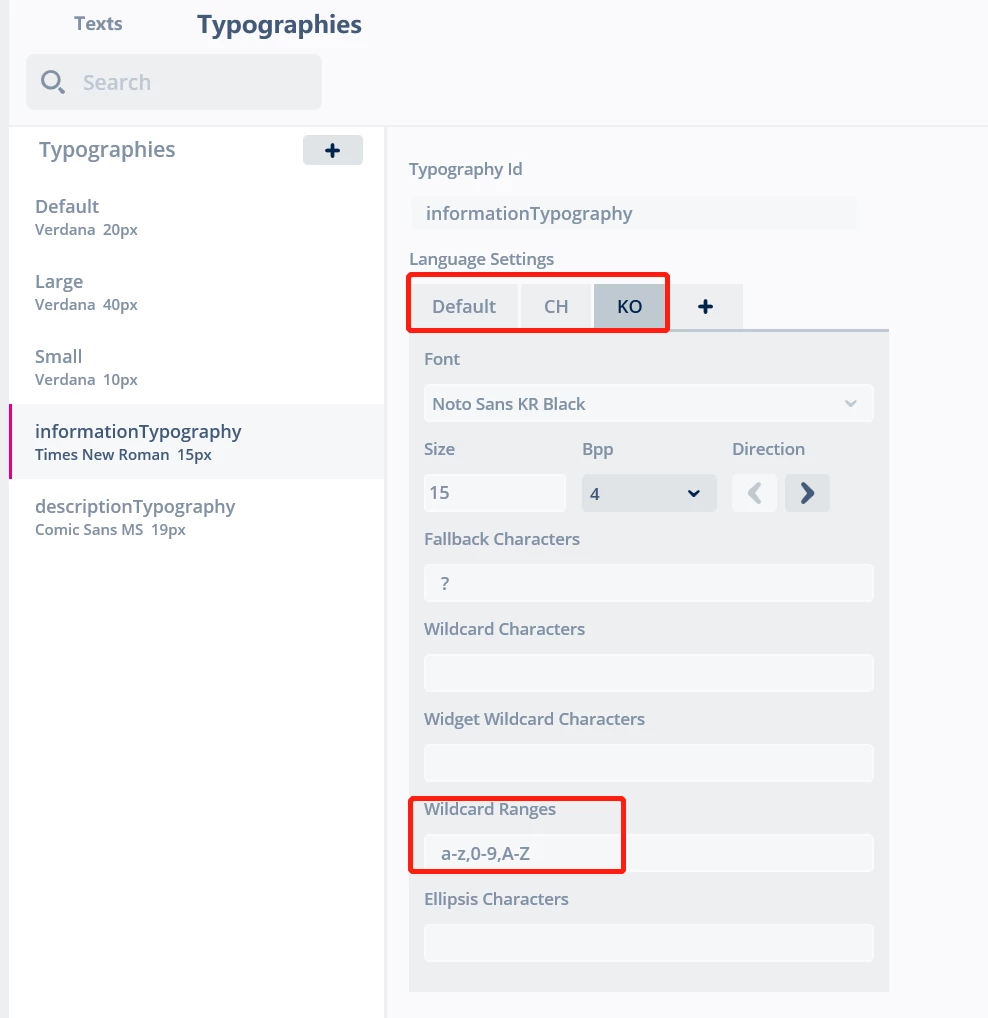

Mar 9, 2023 8:57 AM UTC
All of the languages need add the wildcard range as below:

Mar 9, 2023 2:56 PM UTC
Hello @Osman SOYKURT​ ,
Thanks for your reply. You are right, I found I forget to add the wildcard range for others langrage.
