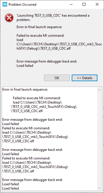

QSPI W25q128 and TouchGFX: error in the final launch stage
Hello!
I'm using TouchGFX for a project, LCD and touch module are OK, but I have some problems with the QSPI driver (W25Q128 module).
I'm able to compile all the code and I see QSPI flash memory as used, but it gives me an error in "final launch sequence".
After including stm32746g_qspi.h (well, my board is an H743, but this file is modified by the vendor Waveshare: even if the name seems wrong, as you can see, it includes H7 headers):

Finally, I modified my linker file and after compiling (without error) I can see the ToughGFX ExtFlashSection loaded in QUAD SPI.
0693W000007C3MqQAK.pngThe problem is that the firmware isn't loaded on my board and I have this error:
0693W000007C3QOQA0.pngCan someone help me?
Thanks and Best Regards!
You've got to love the steaming heap that's been delivered here..
Yeah, so that's probably not related to your code, but rather the need for an external loader at the download/debug level that can handle your custom hardware. The processor doesn't have any internal way to deliver data to external memories (random devices, using random pins, etc, billions of possibilities)
Tools like STM32 Cube Programmer need a custom "External Loader", as small RAM based loader applet that configures the clocks, pins, peripherals and implements Erase, Write and Read functionality.
If you have an External Loader (.stldr) you need to tell the tools about it, where to find it, etc.
If you don't have one, you've got to write one. Or find one. I've posted ones for the W25Q128 in the past.

Now I'm trying to create my external loader: in STM video MOOC(video n°5) a quadspi.c and a quadspi.h are copied from the QSPI Drivers directory (in external loader example). In quadspi.c some functions use defined values:
uint8_t CSP_QSPI_WriteMemory(uint8_t* buffer, uint32_t address,uint32_t buffer_size) {
	QSPI_CommandTypeDef sCommand;
	uint32_t end_addr, current_size, current_addr;
	..... //some code lines
	sCommand.Instruction = QUAD_IN_FAST_PROG_CMD;
	sCommand.AddressMode = QSPI_ADDRESS_4_LINES;
Because I'm using a different product (W25Q128) I have to modify quadspi.h according to my chip ... but "QUAD_IN_FAST_PROG_CMD" isn't defined in my W25q128.h file (attached in my prev message), only QUAD_INPUT_PAGE_PROG_CMD! The same happens with other instructions.

There isn't uniformity in the naming between ST, WAVESHARE and WINBOND vs MICRON, suggest you pull the data sheet so you understand the expectations in address and data widths..
#define QUAD_INPUT_PAGE_PROG_CMD            0x32

My idea is to create, step-by-step, an ExtLoader also for a "didactical" approach, but I think that the porting of a driver is not so simple...
I have a question: if I use CLIVEONE-W25Q128_STM32H7XX-PB2-PB6-PF8-PF9-PE2-PF6.stldr with a simple program (just an initialization of QSPI device on proper pins) -after disabling the "verify flash download"- I have no problems (but I don't try to access QSPI Flash).
With TouchGFX all seems more problematic: the compiling phase is OK but the screen shows no images.
During the programming, a message "handle_vCont_c, continue thread" is displayed . Is it normal?

I'm having the same problem in my project, i can write, erase sector, read the memory W25Q128JV, but I'm trying to generate a custom loader for my project using the touchGFX for STM32H7B3VI with mappedmode, but nothing is working for now.
Could you share your example project to generate the custom loader with me?
I saw the link from github that @Community member​  sent you, but none of those have my pinout.

Yes you are right, this parts are pretty good to IHM application, if helps i have my C code for communication with the memory, the function are working, and as you told are some difference between QSPI and OSPI code.
I'm working now at the file LOADER_SRC to adapt this one to generate the right external loader, based on the post of below.
https://community.st.com/s/question/0D53W00000e1oaTSAQ/external-loader-works-on-stm32cubeprogrammer-but-read-operation-returns-incorrect-data
https://github.com/manoloaterol/MCUDEV_DevEBox_H743-W25Q64-EL/blob/master/Core/Src/Loader_Src.c

hi @Community member​  this is good.
i Did work my custom loader for STM32H7B3 with W25Q128. please look my project, everything is working. the project now is okay, we have to make some initialization on the main.c to the touchgfx works well.
