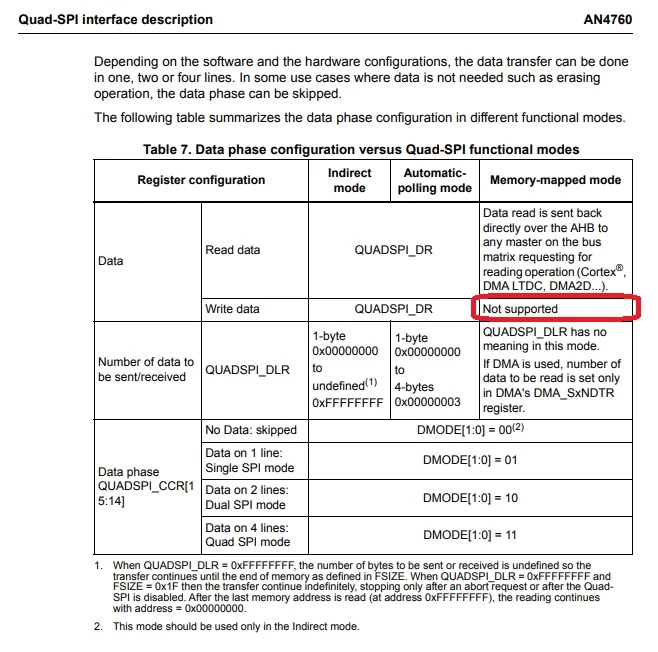

Ok, so where we get into the implementational weeds here is that you can't Write in Memory-Mapped mode, and you can't concurrently use Memory-Mapped with the other modes you can Read/Write with.
0693W00000DqNquQAF.jpg#PlanSurvivesFirstContact

I don't think the F479 supports QSPI RAM.
Personally I think the bandwidth would be significantly constraining, basically halved by need to render, and update the frame-buffer.
You could perhaps serve static images from QSPI NOR Flash, perhaps you should try that, see if the rips, or has contention issues.
The DSI allows for a smaller more routable cable, the design and screen placement in your final design might dictate the interfacing you choose.
A cable with 26+ conductors banging rail-to-rail at 25 MHz with all sorts of modulation might a significantly more complex radiator.

"I don't think the F479 supports QSPI RAM"
Let me rephrase that..
It's not going to support it in a way that rational developers would need/want it too to achieve goals of acting as a random access memory, within the MCU address space, with read, write and DMA operation.

If you look at page 11 of AN4861, it says:
"There are volatile Quad-SPI SRAM (static random-access memory) available from Microchip, ON Semiconductor and others. Available non-volatile Quad-SPI Flash memories. NOR, NAND"
So that made me think that it does support it. However, I can't find anyone that does use it, let alone for a framebuffer so I'm not hopeful.
Your point about parallel vs DSI is certainly a fair one and probably something that will push me more toward DSI.

I think the app note covers a lot of territory, not seeing that quote in V3
https://www.st.com/resource/en/application_note/dm00287603-lcdtft-display-controller-ltdc-on-stm32-mcus-stmicroelectronics.pdf
One of the F479 pages says "The Dual-mode Quad-SPI running at 90 MHz enables cost-effective NOR Flash and supports memory-mapped mode.", and I'm pretty sure it is an early instantiation of the QSPI peripheral, and only recall it having a singular template for the memory-mapping mode, which is what the LTDC is going to need to fetch against.
