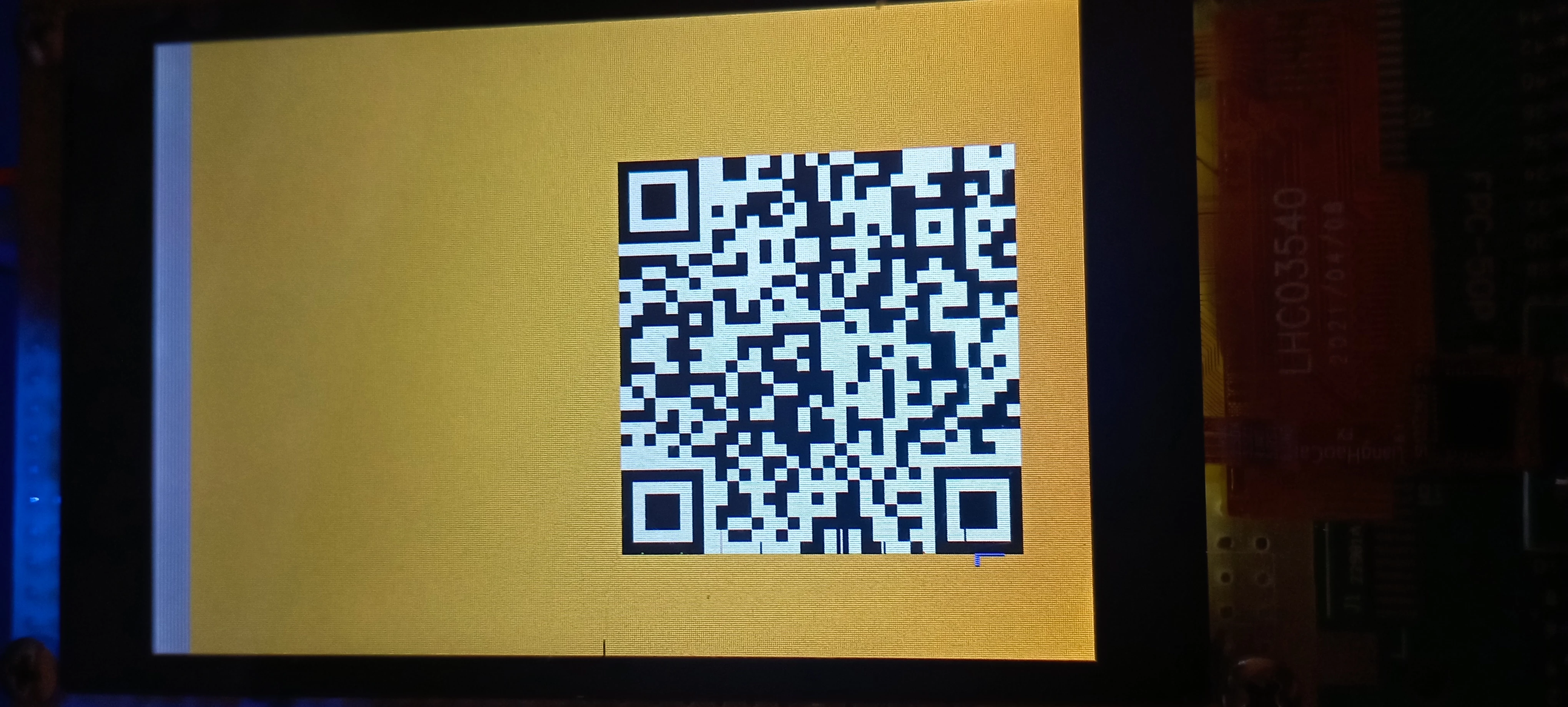

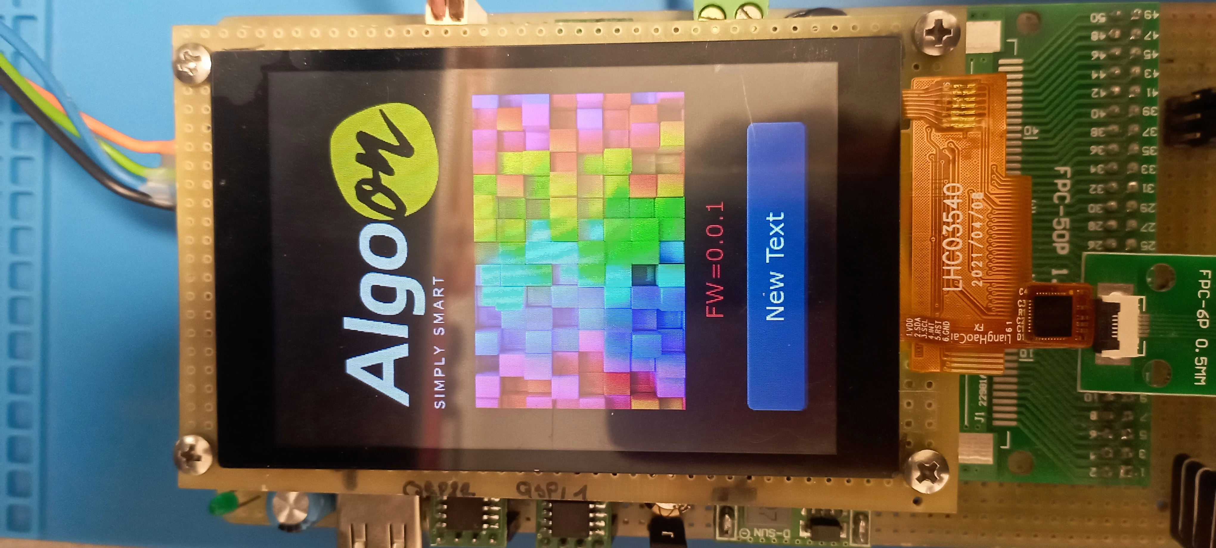

Hi everybody,
I'm trying to implement into a custom board, the dynamic Qrcode generation algorithm.
I'm using touchgfx 4.23.0, an SPI display with partial buffer strategy.
I would like to draw the string "https://support.touchgfx.com" . Display seem to draw it correctly but when I'm try to read it using my phone, this one is not readle. it seems not valid..
I'm using the following initialization sequence:
void Screen_QrCodeView::setupScreen()
Screen_QrCodeViewBase::setupScreen();
QR *code;
sprintf( string, "https://support.touchgfx.com");
code = new QR( string );
qrCode.setXY(10,10);
qrCode.setQRCode(code);
qrCode.setScale(8);
add(qrCode);

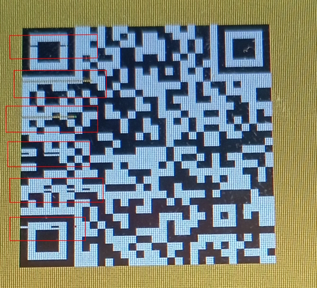

display screendisplay screenQrcode detailQrcode detail
I don't understand the reason. If I change the size of QrCode using qrCode.setScale the result is the same.
Is it possibile to change the resoltuion of the QrCode? Is the QrCode resolution too poor respect the modern APP algorithm?
Does someone ahs the same issue? Please, Can someone try to draw the string https://support.touchgfx.com and share the picture for a comparison, ?
What can I check in the project?
Thanks to all

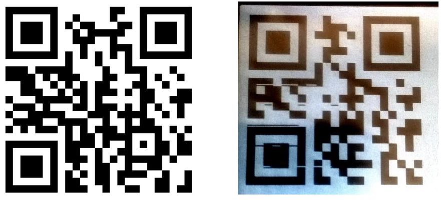

Feb 24, 2024 9:22 AM UTC
Why your Qrcode is so different?
Can you share your sources files, you use in the project?
Thanks
Andrew Neil
Feb 24, 2024 9:41 AM UTC
Indeed it's very different:
Apart from the "tearing", yours seems to be missing a lot of points
Andrew Neil

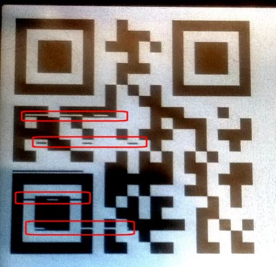

Feb 24, 2024 9:36 AM UTC
What makes you say that?
It's drawn something - but, clearly, what it's drawn is not correct!
There's a lot of "tearing" in your image:
Can you correctly draw any other text as a QR code?
You haven't shown the definition of string
What if you just do
code = new QR( "https://support.touchgfx.com" );

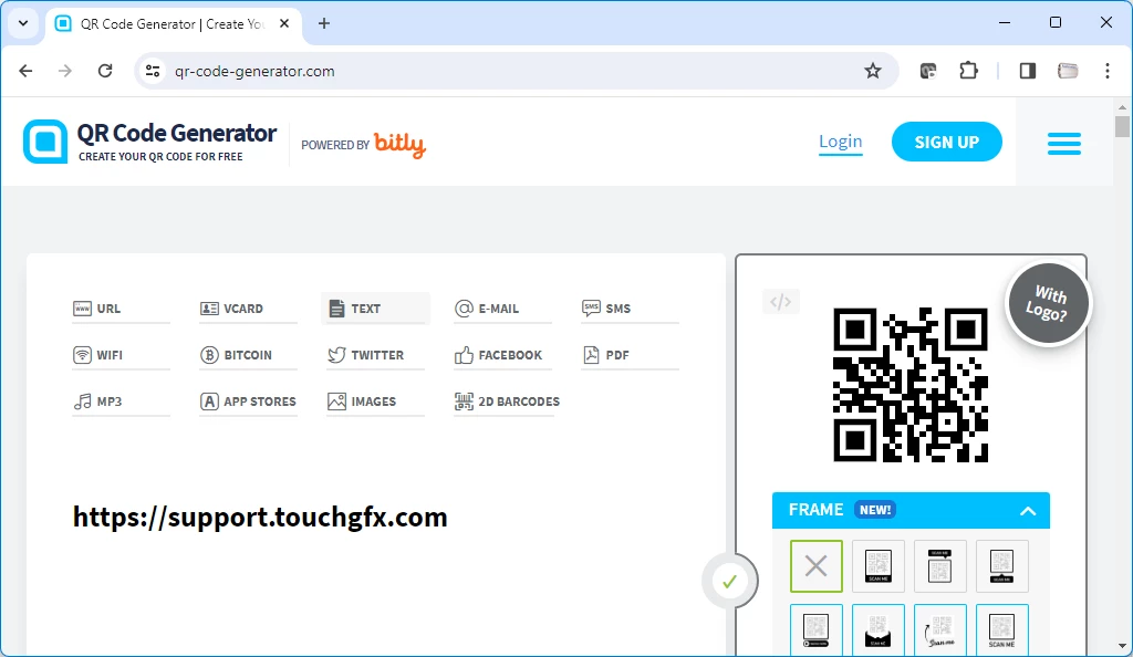

Andrew Neil
Feb 24, 2024 10:32 AM UTC
This site gives what looks like the same result as @Pavel A.
https://www.qr-code-generator.com/

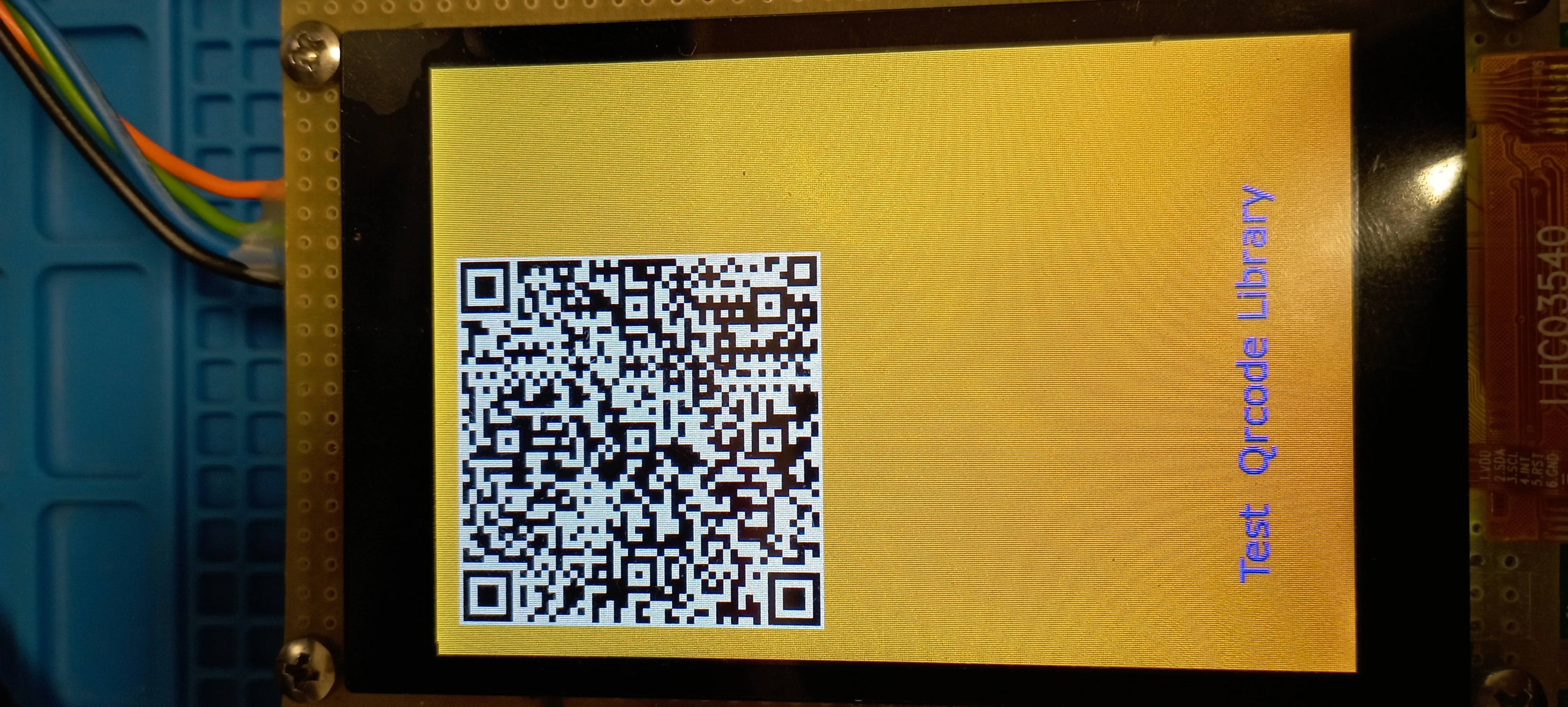

main screenmain screen
As you can see an example of correct scren with buttons, text and images.
String as decalred like "char"
QRCodeWidget qrCode;
char string[50];
Can be depend by display orientation?

After updating Code with others sources files, finally Now it works correctly: I can rappresent anykind of text.
Remain to understand why is so dirty. Should the parial frame buffer system be the cause?
Graduate II
Feb 24, 2024 4:46 PM UTC
Hello
I think it is possible, are you rendering it directly to the framebuffer like in this example:
https://support.touchgfx.com/docs/development/ui-development/touchgfx-engine-features/custom-widgets#example-source-code
What if you set scale to 1, can you still see 'dirty' pixels ?
Br JTP
MPast.1
MPast.1Author
Senior
Feb 24, 2024 6:36 PM UTC
The problem is always present when setScale is set more than 2.
It seems that algorithm forgot to draw and compiles wrong pixels.. very strange..

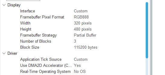

Another observation = I use 3 "large" buffer for draw screens..
If I don't wrong in 115200 bytes Touchgfx could draw 120 full rows . (my calcualtions= 115200 / (320 columns * 3 bytes (RGB)) = 120 rows). I know that partial buffer mode doesn't draw screens like single buffer, but I think that my buffer size can be enought fro draw a small square (100 x 100 pixel) on the screen.
At this point I need to check what happens inside the QrCode algorithms

MPast.1
MPast.1Author
Senior
Feb 29, 2024 7:35 PM UTC
hi @GaetanGodart ,
sorry for my late response but I want to confirm you taht your solution works perfectly.
I try different sizes and everything is drawn correctly without any wrong pixel.
Thank you very much
