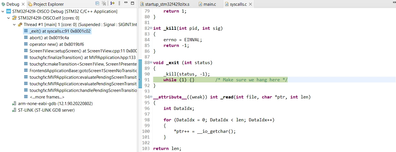

My program runs on simulator but does not show any QR code on screen. I tried to debug the code. it hangs in exit().

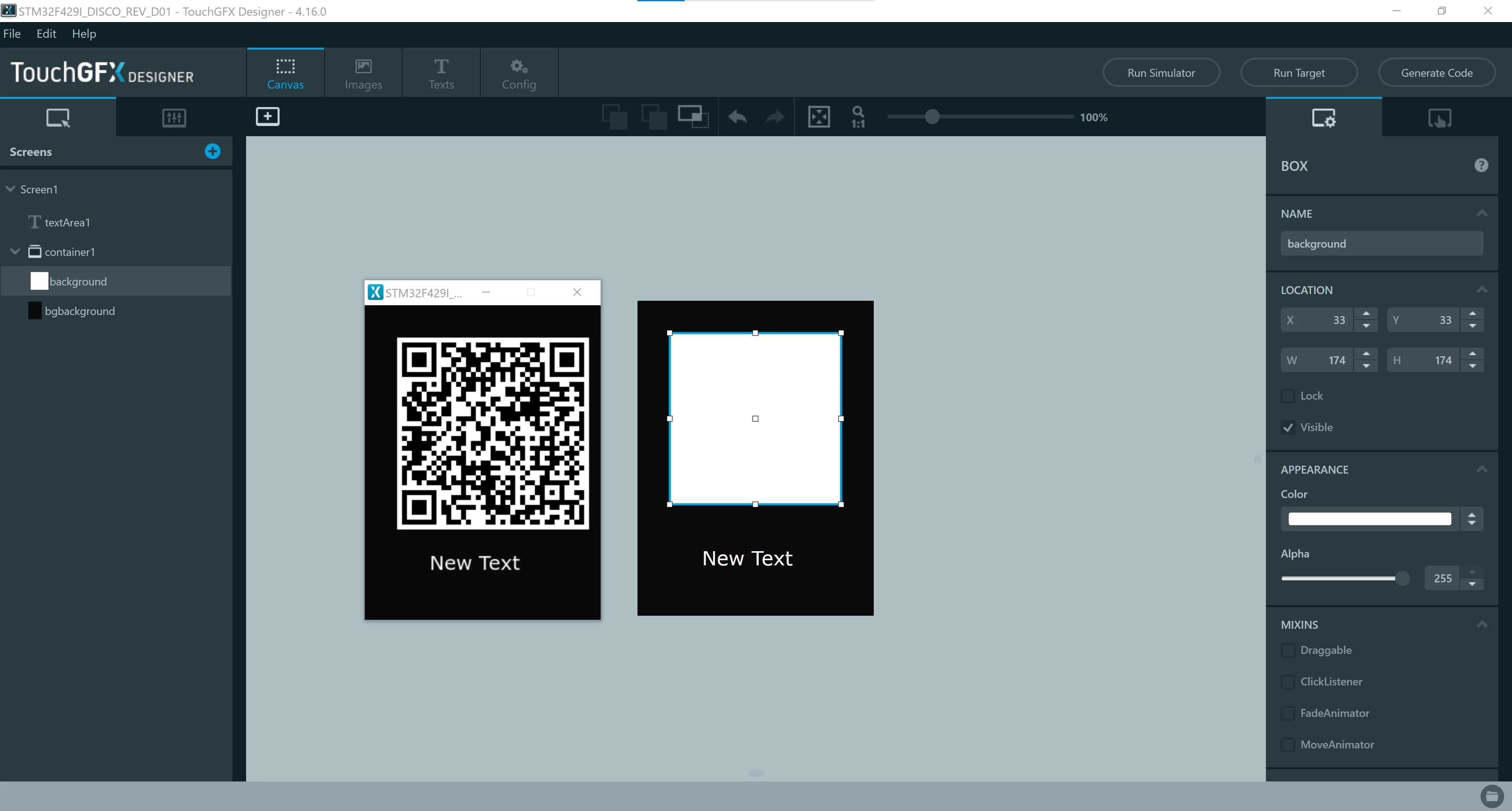

I tried your example and it worked fine on the simulator.
Simulator showing the QR CodeSimulator showing the QR Code
However, when you try to run the code on the target, for some reason the new command causes trouble. If you try to rewrite the code in a manner that avoids new, you should be able to run it on your board.

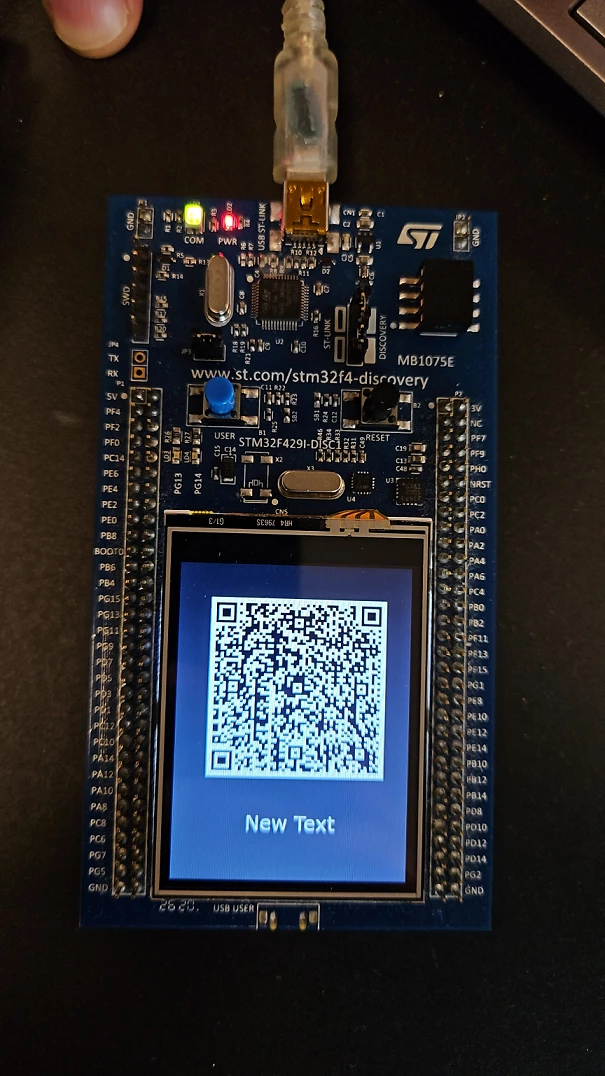

Project running on STM32F429I-DiscoProject running on STM32F429I-Disco

1)For the changes you suggested- Qr code is displayed on board but to generate QR Code dynamically
