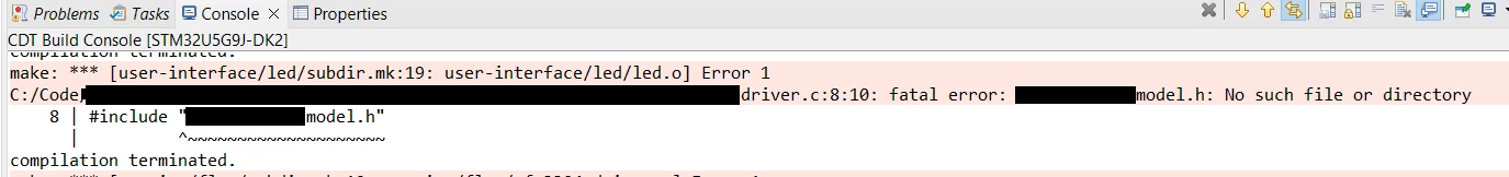

The first build usually shows some errors with include files in the Console:
At this point the progress bar shows ~25%.

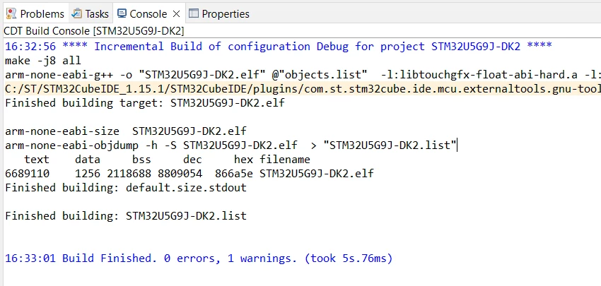

The above Console errors are quickly overwritten by the second "build" which works OK:

Based on the first error, it seems like you have added some code related to led, however, the compiler cannot figure out how to connect this code with the rest of your project. And, I guess what happens is that STM32CubeIDE reverts and uses the previous successful build.

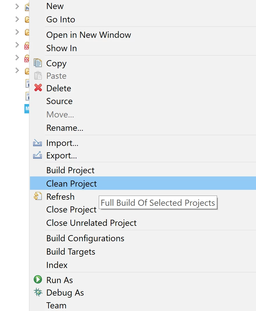

Cleaning ProjectCleaning Project

It doesn't seem to matter whether I run "Clean Project" prior to "Build Project".  In the current state, the IDE runs two compilation flows regardless.
Since the Console is cleared and reset by the second compilation flow, I can't capture the Console of the first build very well.  The log file also doesn't show the first build output. From what I can tell as the Console flies by, the first build appears to do `make -j8 all` just like the second build...  But for some reason it has errors while the second does not.
I confirmed the project paths are correct (else I don't think the second build would succeed).

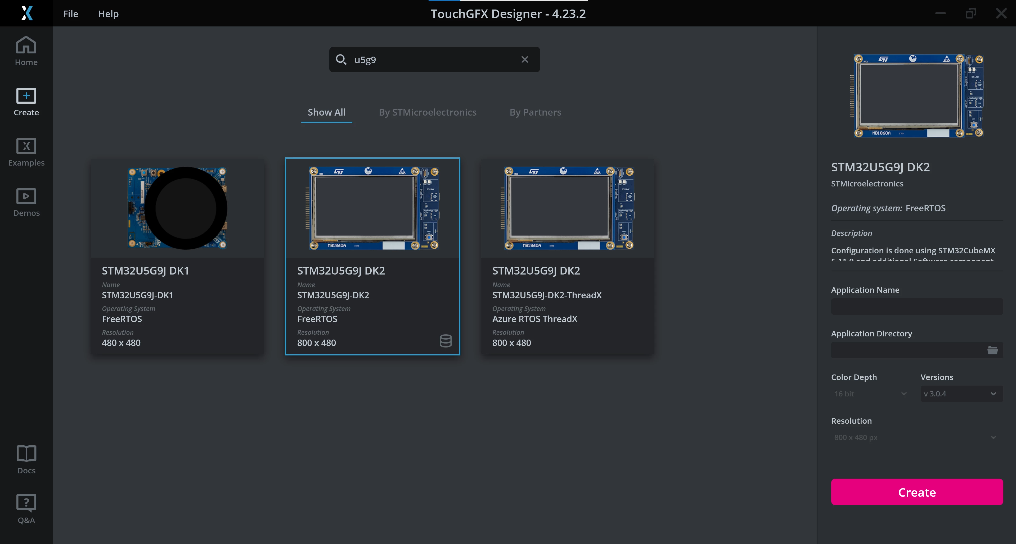

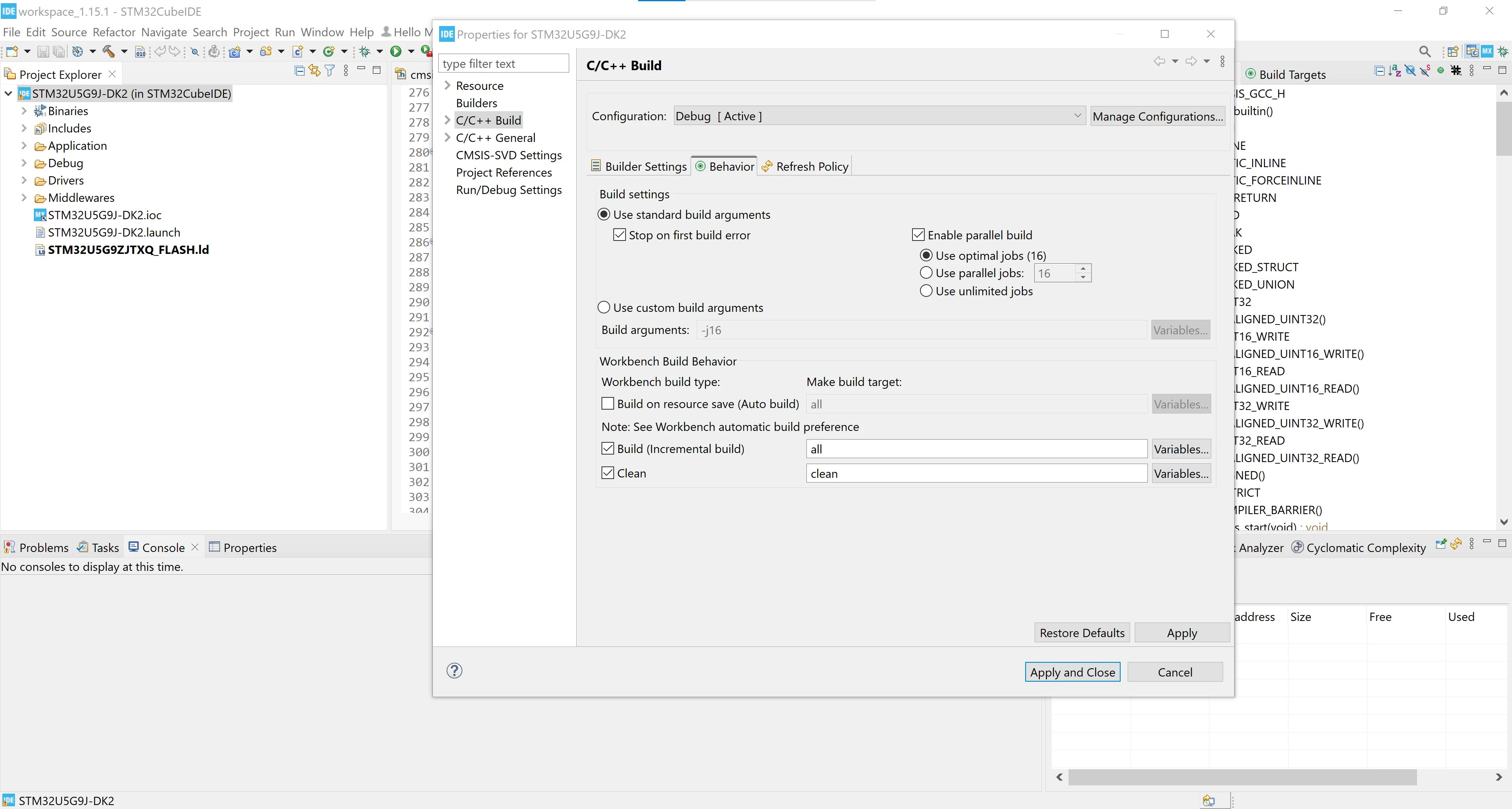

In the STM32U5G9J DK2 project that TouchGFX Designer creates, make -j16 is used for the STM32CubeIDE project build setting (Parallel build). I'm now a bit suspicious about other possible changes in the project properties.
STM32U5G9J DK2 TouchGFX Board SetupSTM32U5G9J DK2 TouchGFX Board Setup
Could you please share your project?
Mohammad MORADIST Software Developer | TouchGFX

I cannot share the entire project in its current state since it is proprietary.  Starting a new project from TouchGFX as shown in your screenshot above is basically how I did it initially, and should give the same results if repeatable.

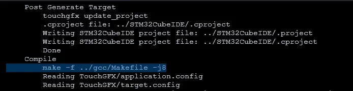

To my knowledge, both the IDE and TouchGFX have always used `-j8` in their compilation.  Snippet of TouchGFX build below:

Yes, TouchGFX uses -j8, however, the default settings for STM32CubeIDE in C/C++ Build -> Behavior should look like this:
Default build settings used by generated project from TouchGFXDefault build settings used by generated project from TouchGFX
Although, I don't think the issue stems from these settings because I'm not able to replicate the issue you are talking about. And, as I mentioned earlier, from the error that you have attached, your custom-added files are not correctly recognized by the compiler. But, I don't understand how the 'second build' can be successful if there was an error in the first one.
