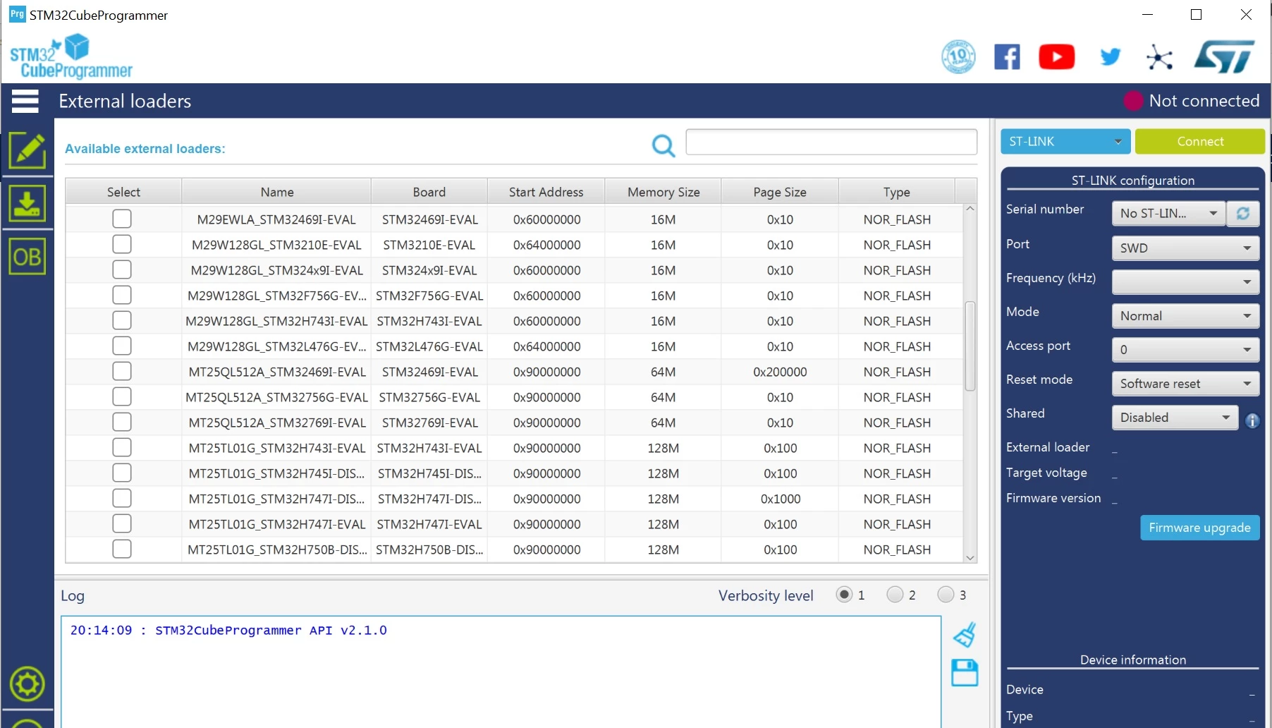

Dejan Nedeljkovic
Aug 5, 2019 12:27 PM UTC
Hi @hansd56​
The external loaders in STM32CubeProgrammer are only for the specific ST boards.
I have already tried some loader in this tool and didn't get it working.
I think my board is only working with a customized loader.

Dejan Nedeljkovic
Aug 6, 2019 7:13 AM UTC
Thanks for all your responses.
I have tried to modify N25Q512A_STM32F769I-EVAL loader in Atollic TrueStudio. The build was successful and I renamed the .elf file to .stldr and copied it to the bin folder of ST Link-Utility and Cube Programmer. Both Tools are not displaying the modified external loader.
I have followed the instructions of UM2237 and the readme file of N25Q512A_STM32F769I-EVAL loader.
Has someone a hint for me?
Regards
Dejan

Dejan Nedeljkovic
Aug 6, 2019 11:48 AM UTC
Hi @eng23​
I've opened the .project file. Then created a folder "Loader" in the project and linked the c-files (as shown in the screenshot).
I got it compiling but it didn't work with the ST Link-Utility and Cube Programmer.
The ST Cube Programmer shows that it couldn't load the external loader.
