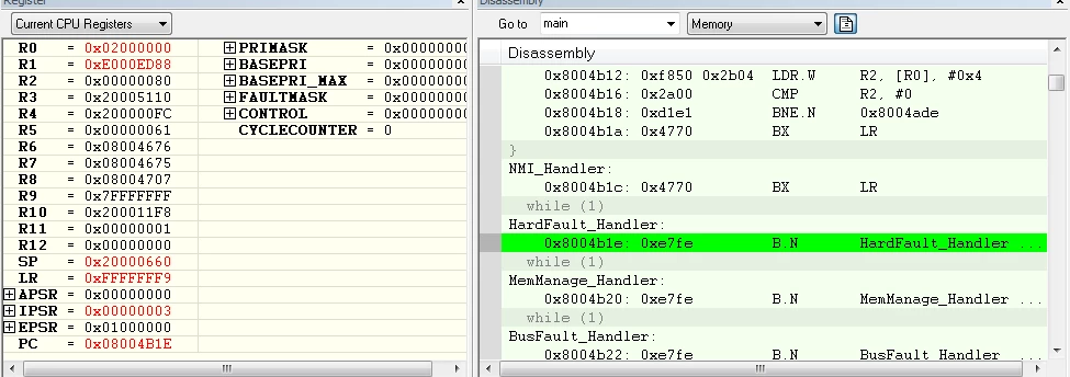

I am trying to add STemWin Library in program but as I am adding it in code, the program doesn't move to entry point on debug i.e. main(). I have tried following approaches to fix it.
1. Changing Linker File data (RAM Range, ROM Range, Stack and Heap Size) [File_1]
2. Changing memory allocation in LCDConf.c and GUIConf.c that allocates memory to STemWin.[File_2]
3. Changing IAR Settings in debugger 'Tick and Untick' > Run to 'main'[File_3]
I have attached all the related files.

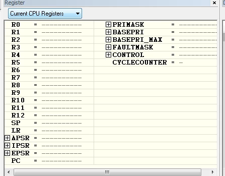

Observation : All the registers including PC are not initialising with their initial values on debug.
It would be highly appreciated for any kind of suggestion or options.
Have tried to untick 'run to main', and then debug through the startup code - from the reset vector on ?
I guess either clock settings or some peripheral initializations (graphics) fail, perhaps with a memory-related problem.
