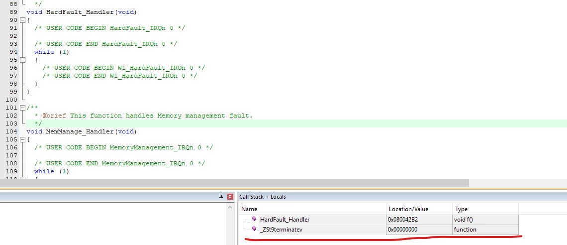

Tesla DeLorean
Guru
September 23, 2020
Have a functional Hard Fault Handler so you can catch failures there.
The constructors may be called before external memory and peripherals are functional.​
Wrend.1
Wrend.1Author
September 24, 2020
How can I find the cause of hard fault.
