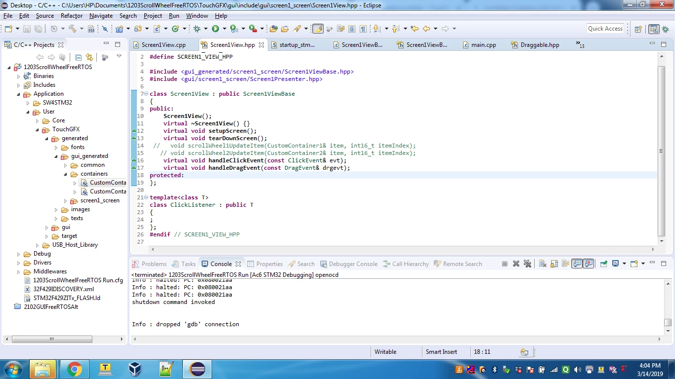

I am configuring ScrollWheel on touchgfx.
In order to select an option, I need to click on ScrollWheel.
In order to browse all the options, I need to drag on ScrollWheel.
So, I need both handleClickEvent() and handleDragEvent().
I also need to differentiate between a Click and a Drag action.
But, upon drag action, my program control goes in handleClickEvent() only.
It never reaches handleDragEvent() function.
Please suggest how can I detect Drag event?

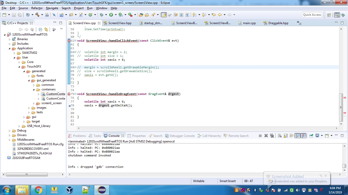

If you're debugging while trying to get both a click and a drag event you may run into some issues because you're releasing your mouse when you hit the first breakpoint.
The first event you'll get is a Click Event (PRESSED) then continuous drag events every tick with the delta for x and y, and then finally a Click Event (RELEASED) when releasing.
You could try printing things into the console rather than using breakpoints. You're doing it right, just overriding handleClick- and -Drag event methods.
