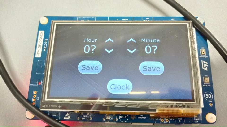

Hello :)
I'm new with TouchGFX and I'm doing official TouchGFX tutorials.
I came up with the problem - code is properly generated and target/simulation can be run, but when I use buttons up/down then not number but question mark is displayed.
I'm using STM32F7508-DK.
0693W00000GZBZLQA5.jpgDoes anyone have any idea what is the problem?
Best answer by MM..1
You need manage characters used in application fonts in designer typography lists. Not listed is replaced with ?
2 replies
MM..1
MM..1Best answer
November 28, 2021
AWe.1
AWe.1Author
November 28, 2021
@MM..1​ It works! Thank you! :)
