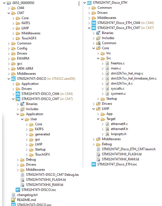

On the left is the TouchGFX generated Project, which links only some files to the CM7 Subproject and on the right is the example project which has the files directly included in the CM7 subproject
Thank you for any help and hints!

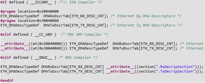

Regarding MPU: It is important to set correct parameters for TX and RX DMA descriptors:
1. in linker LD file check .lwip_sec section for addresses in use
2. in ethernetif.c you should check corresponding __attribute__((section(".XxDescripSection"))); at DMARxDscrTab[] and DMATxDscrTab[]​ arrays
3. in main.c check that region set for DMA descriptors in linker LD file have:
  • MPU_TEX_LEVEL0
  • BUFFERABLE
  • NOT_CACHEABLE
  • SHAREABLE
  • INSTRUCTION_ACCESS_DISABLE
attributes. CubeIDE can set single attribute in the beginning of function and then use it for many sections. So check what is set in sections above 4 and if you are going to change it manually, then also think about sections below you have just changed.

2. in ethernetif.c DMARxDscrTab[] and DMATxDscrTab[]​ arrays also seem to be inactive. So I think this could be the error. I noticed before that some defines can't be found because only c files are linked into the project.

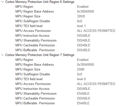

3. in main.c these are the regions I had added. Access Permission was set to ALL ACCESS NOT PERMITTED. I changed it, but still can't ping the board.

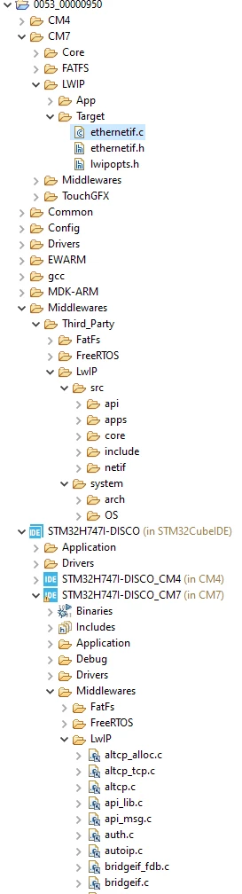

Rebuilding the index does not solve the problem. I checked the comiler flag: it is set to __GNUC__ in the project, but the ethernetif.h and .c files are not linked in the project. They are located in the CM7/LWIP/Target/ folder and the STM32H747I-DISCO_CM7 Project has only linked the LwIP files from the Middlewares/Third_Party/LwIP/ folder.
Any advice whats the best way to handle the TouchGFX generated Project? I think it is very unhandy that only some files get linked to the project. For example defines in main.h are not known to files in the project which include main.h. Do I have to add new .c and .h files in the CM7/Core/ folder and link them to the project?

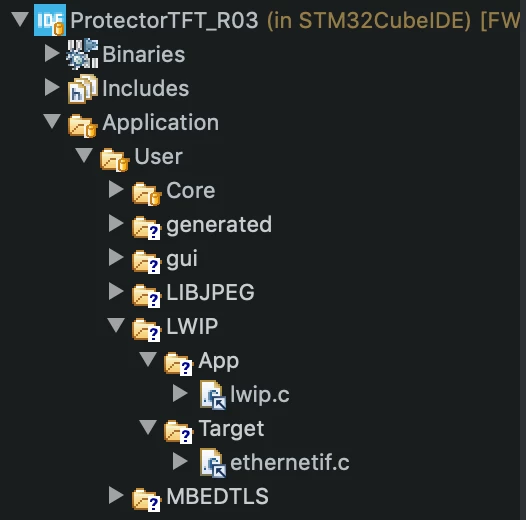

Here is my project structure:
0693W00000QKGNeQAP.pngBoth lwip.c and ethernetif.c are located in LWIP\Target folder and linked to the project:

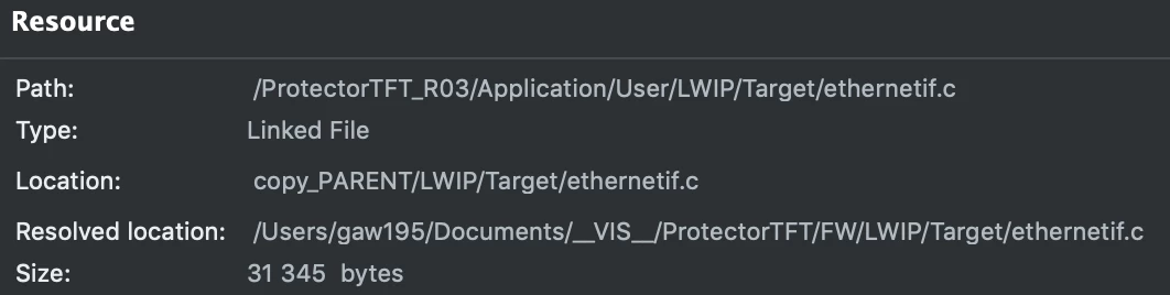

Thanks, now I see it, too! It's the same link in my project and when I open ethernetif.c with the link, the compiler flag for __GNUC__ is recognized.
