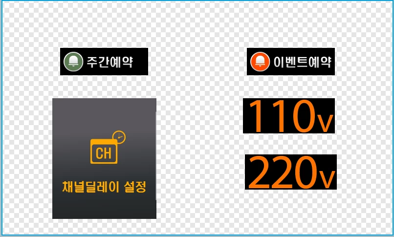

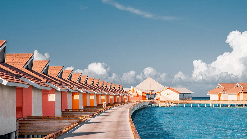

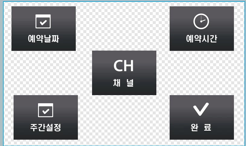

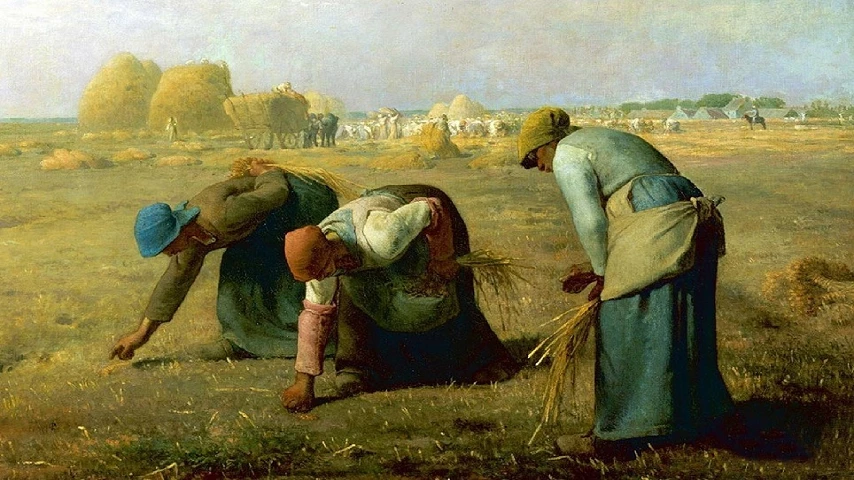

The stm32f469 board is connected to the LCD of the MIPI interface.
I made ScreenA, ScreenB using TouchGFX.(4.16.1)
It operated ScreenA -> ScreenB -> ScreenA -> ScreenB every second.
In the same program, sampleA put five images and sampleB put one picture.
Tests showed that the SampleA did not display LCD over time, and that the SampleB continued to display LCD over time.
The question is that the LCD was displayed with only different number of picture files in the same program, but I don't know why the LCD of sampleA with 5 pictures is not displayed.
Is there anything I should be careful about displaying in TouchGFX?
Romain DIELEMAN
Romain DIELEMANBest answer
July 12, 2021
Well it depends on your hardware and how much rendering is required. If you need to update 5 different images at the same time it might miss a frame (see performance article). Instead of update all images at once you could try to update only 3 images in one frame then the other 2 in the next one I guess.
