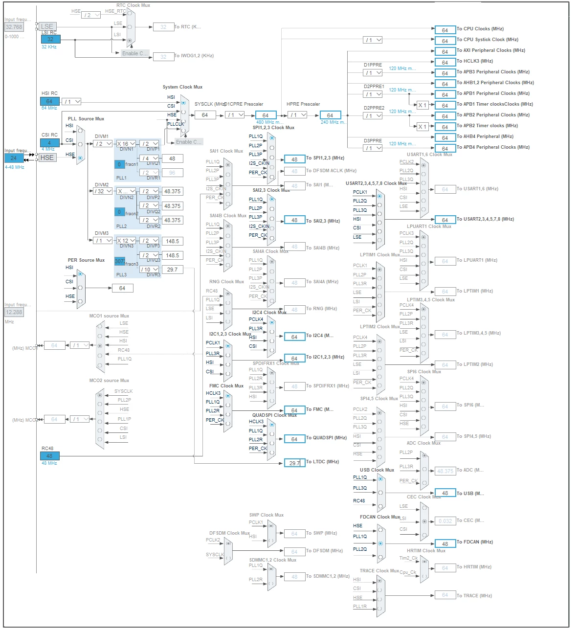

I have problems with CubeMX, to generate the correct timing. I have a working timing configuration set, done “by hand�?.
I would like to be able to generate it from CubeMX, so I can still continue use it to update the generated part of the project,
But I’m not able to set clock-timing, that generates a working set of settings.
I tried to identify which parameters I should modify, to receive the desired set of settings, but was not able to make this kind of “reverse work�?
Can you help me?

   /*## LTDC Clock Configuration ###########################################*/
   RCC_PeriphCLKInitTypeDef periph_clk_init_struct;
   /* DISPLAY_ILITEK LCD clock configuration */
   /* LCD clock configuration */
   /* PLL3_VCO Input = HSE_VALUE/PLL3M = 5 Mhz */
   /* PLL3_VCO Output = PLL3_VCO Input * PLL3N = 800 Mhz */
   /* PLLLCDCLK = PLL3_VCO Output/PLL3R = 800/83 = 9.63 Mhz */
   /* PLLLCDCLK = PLL3_VCO Output/PLL3R = 800/15 = 53 Mhz */
   /* LTDC clock frequency = PLLLCDCLK = 9.63 Mhz */
   periph_clk_init_struct.PeriphClockSelection = RCC_PERIPHCLK_LTDC;
   periph_clk_init_struct.PLL3.PLL3M = 5;
   periph_clk_init_struct.PLL3.PLL3N = 160;
   periph_clk_init_struct.PLL3.PLL3FRACN = 0;
   periph_clk_init_struct.PLL3.PLL3P = 2;
   periph_clk_init_struct.PLL3.PLL3Q = 2;
   periph_clk_init_struct.PLL3.PLL3R = 27; // 30 MHz: 800/27 = 29.6 MHz
   // periph_clk_init_struct.PLL3.PLL3R = 20; // 40 MHz: 800/20 = 40.0 MHz
   // periph_clk_init_struct.PLL3.PLL3R = 32; // 25 MHz: 800/32 = 25.0 MHz
   // periph_clk_init_struct.PLL3.PLL3R = 13; // 60 MHz: 800/13 = 61.5 MHz
   // periph_clk_init_struct.PLL3.PLL3R = 12; // 65 MHz: 800/12 = 66.7 MHz
   // periph_clk_init_struct.PLL3.PLL3R = 16; // 50 MHz: 800/16 = 50.0 MHz
   // periph_clk_init_struct.PLL3.PLL3R = 15; // 55 MHz: 800/16 = 53.3 MHz
   // periph_clk_init_struct.PLL3.PLL3R = 17; // 45 MHz: 800/17 = 47.1 MHz
   // periph_clk_init_struct.PLL3.PLL3R = 18; // 45 MHz: 800/18 = 44.4 MHz
   HAL_RCCEx_PeriphCLKConfig(&periph_clk_init_struct);
