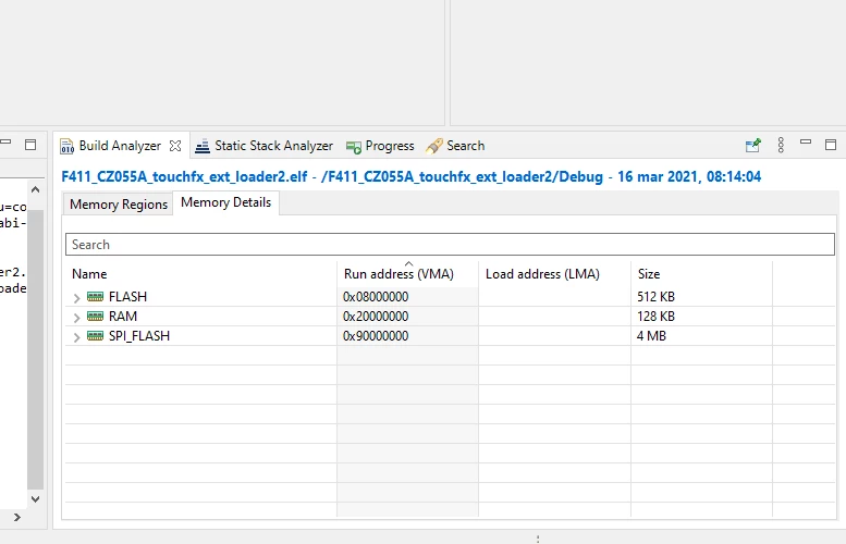

cb.7
cb.7Author
March 16, 2021
0693W000008wzotQAA.pngThanks for the reply.
I create a screen with TouchGFX, press "Generate Code", compile with STM32CubeIDE and everything goes well. The problem is that if I launch the debug from STM32CubeIDE it seems that I cannot find the .BIN file to load in the external flash memory ...

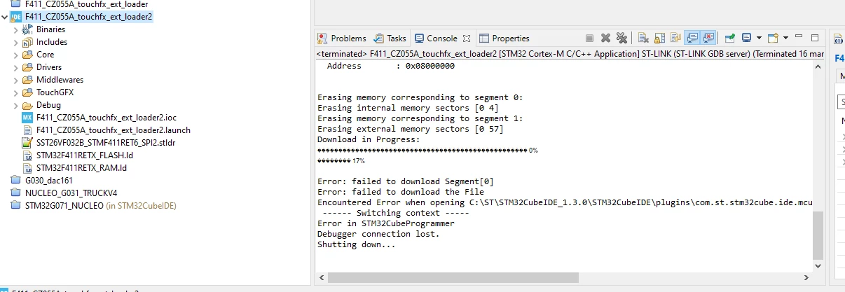

cb.7
cb.7Author
March 16, 2021
I have created an external loader called "SST26VF032B_STMF411RET6_SPI2.stldr" and it works correctly with "STM32CubeProgrammer".
If I launch the debugger it gives me an error as you can see from the attached photo.
Am I wrong to place my external charger in the project?
Alexandre RENOUX
Visitor II
March 17, 2021
Hello cb.7,
You are not wrong to use your external loader in CubeIDE which you used in CubeProgrammer. That is the correct procedure.
As why you cannot download into the board is not related to TouchGFX and I'm not an expert in CubeProgrammer/CubeIDE. Maybe try to add these tags to your request.
One thing you could try is download using CubeProgrammer and then debug without downloading with CubeIDE. I believe this option is available.
Also, after the download is successful with CubeProgrammer, is your project working ? Do you see the images stored in SPI flash displayed on your screen ? If not, are you sure your external loader is correct ?
/Alexandre
