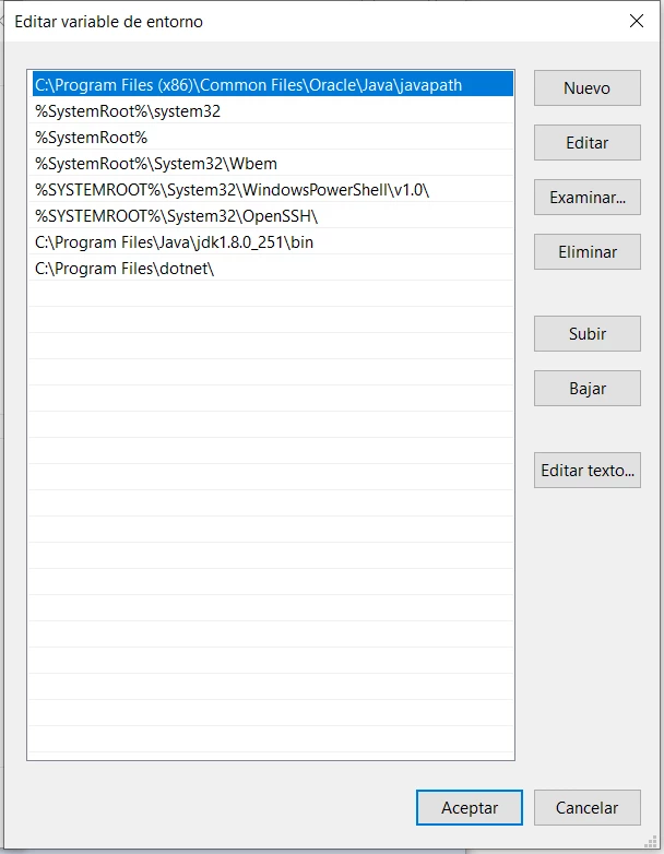

My original problem is when I try to see a GUI example running, when I hit on "Run Simulator" the operation fails and in the detailed log appears the following message:
"Generate Assets
       make -f simulator/gcc/Makefile assets -j8
             0 [main] us 0 init_cheap: VirtualAlloc pointer is null, Win32 error 487
       AllocationBase 0xC90000, BaseAddress 0xDC0000, RegionSize 0xCD000, State 0x2000
       C:\TouchGFX\4.13.0\env\MinGW\msys\1.0\bin\sh.exe: *** Couldn't reserve space for cygwin's heap, Win32 error 0
       make: *** [assets] Error 1
       simulator/gcc/Makefile:32: recipe for target 'assets' failed
       Failed
Failed"
I tried with different application templates and UI templates but the error is the same.
I saw on other thread a possible solution:
https://community.st.com/s/question/0D50X0000BDmRZN/compilation-error-couldnt-reserve-space-for-cygwins-heap-win32-error-0
But it did not work for me to rebase msys-1.0.dll, here are the details:
I executed the same command as recommended but it did not work:
"editbin /rebase:base=0x50000000 msys-1.0.dll"
"msys-1.0.dll : fatal error LNK1342: failed to save a backup copy of the binary file to be edited"
Then I tried to execute it with msys-1.0.dll file which is contained in TouchGFX at C:\TouchGFX\4.13.0\env\MinGW\msys\1.0\bin\msys-1.0.dll but it seems nothing happened because the problem remained.
I executed above commands from the Visual Studio command prompt as stated here:
https://docs.microsoft.com/en-us/cpp/build/reference/editbin-reference?view=vs-2019
Please help :( :sad_but_relieved_face:

Hi. Do you have multiple msys.dlls in your path? From other tools.
AHern.21
AHern.21Author
July 9, 2020
I don't know for sure, I only have these in my path...
I formatted my computer a few days ago, I am recently installing everything again, so I don't have that many applications. Before formatting I had run TouchGFX and it worked properly.
