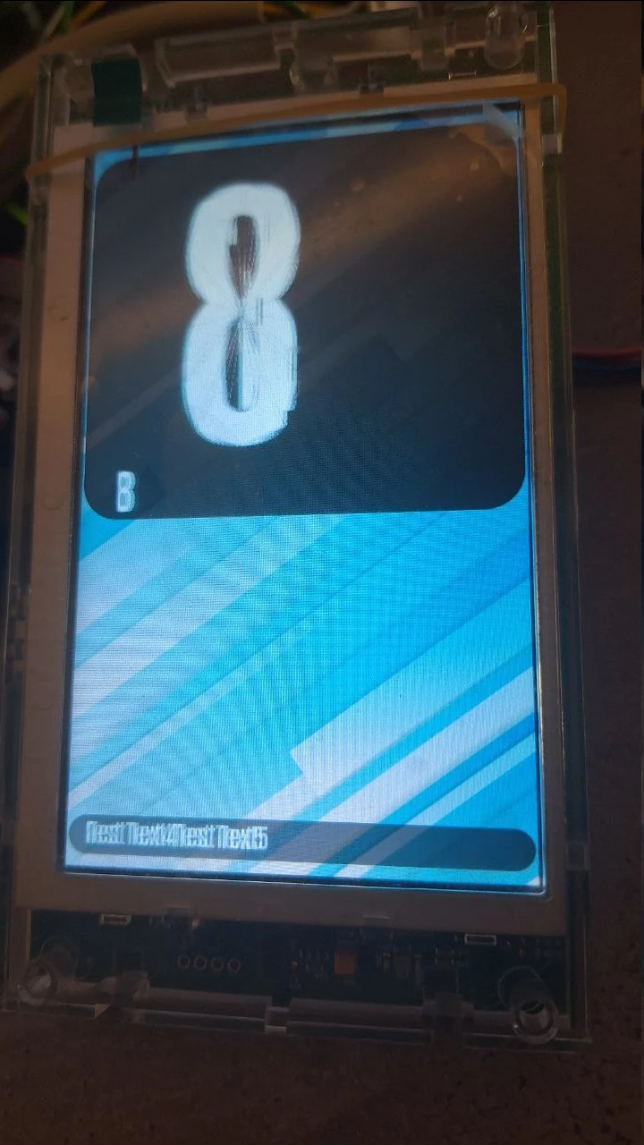

Dear All,
I am working on a project based on the STM32U5G9NJH6Q MCU.
I have made a project using CubeMX v6.14. I am working on CubeIDE and I am using TouchGFX 4.25.0 for the GUI of my application.
I have used the STM32U5G9-DK2 to verify my GUI design, using hardware accelerated vector fonts. On the DK everything seems to be working fine.
But on the custom PCB I am working on, I see this:
The larger font on the screen is a vector font, whereas the smaller fonts are bitmap, so I am using a mix of the 2.
If I do not use hardware accelerated vectors (use software accelerated vectors instead) then the problem disappears, but the GUI is slow. My linker script looks like this:

Despite the naming of the external flash (QUADSPI) I am using a HyperBus Infineon Flash that is connected on OCTOSPI1 of the device, running at 104MHz. Another difference of my hardware and the DK is that I am using a 16bit LTDC, while the DK has a 24bit LTDC.
Any ideas as to what might be causing the issue that I am observing?
Thanks a lot in advance.

Hello @IAnastasopoulos and welcome to the community;
First of all I apologize for my late reply.
Could you please try to decrease the OCTOSPI clock frequency.
The max OCTOSPI clock frequency for STM32U5G is 100 MHz
I hope this help you.
Thank you.
Kaouthar
MM..1
Apr 18, 2025 5:06 PM UTC
Based on linker fonts isnt in QSPI and based on my design U599 with simmilar issues and no QSPI at all i mean no relevant to QSPI.
Then i ask too same. Next info from my design i dont use vector fonts and see same random glitches. Seem GPU2D render have some issue.

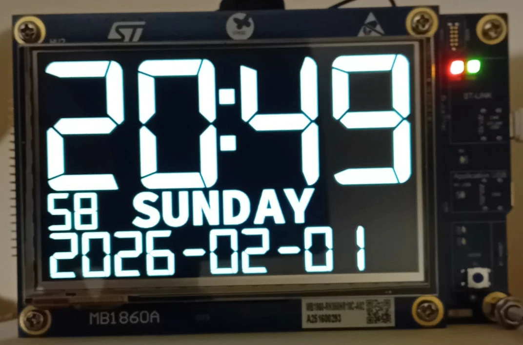

Feb 18, 2026 10:19 PM UTC
Just by the way I'm using opensource library stb_truetype.
I understand it's maybe a palliative solution but it work. Library exists in only one file: "stb_truetype.h" is downloaded from here:
 https://github.com/nothings/stb
And example how I used this is here:
https://github.com/wegi1/STM32U5G9J-DK2-RTC
