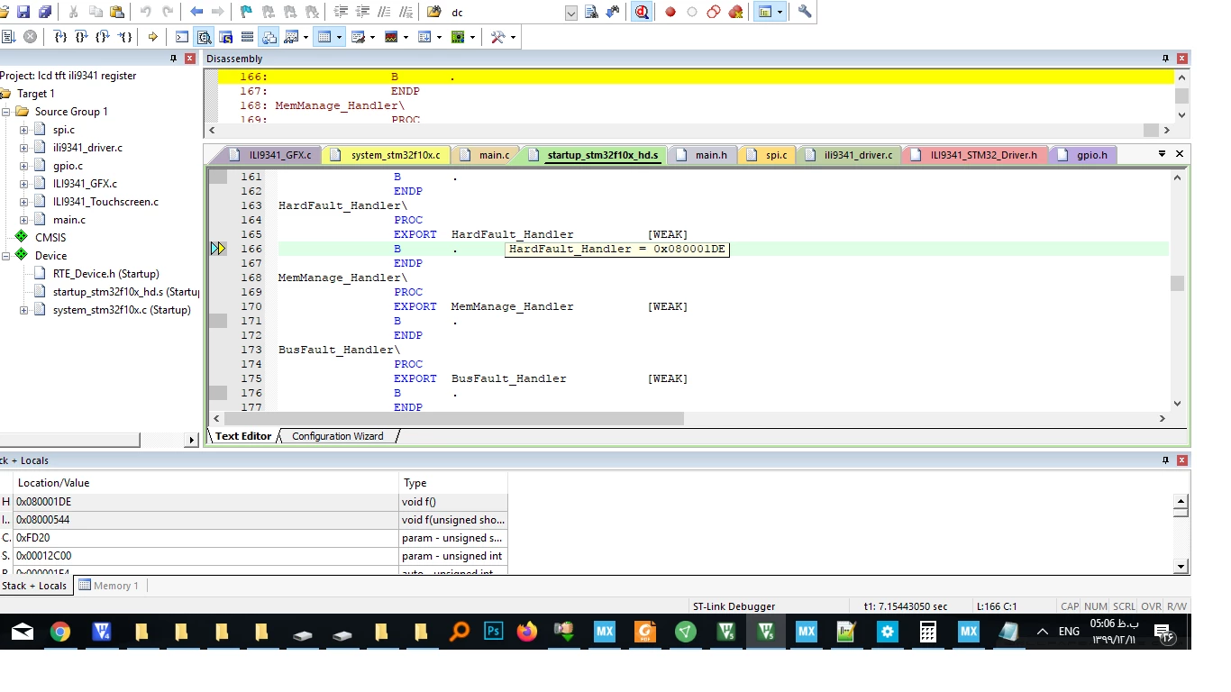

I successfully used a HAL code I found on Github for driving an ili9341 TFT LCD with SPI then I rewrote the code with registers. Part of my code works and I am able to fill pixels with color but when I try to use a function named ILI9341_Draw_Colour_Burst the code doesn't work. I tried to use the Keil debugger to see what happens and it showed a hard fault occurred. The function code is shown below
void ILI9341_Draw_Colour_Burst(uint16_t Colour, uint32_t Size)
//SENDS COLOUR
uint32_t Buffer_Size = 0;
if((Size*2) < BURST_MAX_SIZE)
 Buffer_Size = Size;
else
 Buffer_Size = BURST_MAX_SIZE;
LCD_DC_PORT->BSRR |= LCD_DC_PIN;
LCD_CS_PORT->BRR |= LCD_CS_PIN;
unsigned char chifted = Colour>>8;;
unsigned char burst_buffer[Buffer_Size];
for(uint32_t j = 0; j < Buffer_Size; j+=2)
 burst_buffer[j] = chifted;
 burst_buffer[j+1] = Colour;
uint32_t Sending_Size = Size*2;
uint32_t Sending_in_Block = Sending_Size/Buffer_Size;
uint32_t Remainder_from_block = Sending_Size%Buffer_Size;
if(Sending_in_Block != 0)
 for(uint32_t j = 0; j < (Sending_in_Block); j++)
 write_buffer32((unsigned char *)burst_buffer,Buffer_Size) ;
//REMAINDER!
write_buffer32((unsigned char *)burst_buffer,Remainder_from_block) ;
LCD_CS_PORT->BSRR |= LCD_CS_PIN;

Best answer by salar1991
my problem is solved! I changed the BURST_MAX_SIZE value from 500 to 100 and the function worked! I'm still curious that what was the reason behind the hard fault
i attached an image of the hard fault error of the debugger.

I suppose you are aware of performance limits with a serial connection (SPI) and busy-waits.
I can't see an immediate problem, so I would tackle the problem from the other end.
What do the SCB fault registers say when the hardfault occurs ?
Can you switch to instruction step mode, and step to the critical sections ?
Register values will usually quickly reveal the problem.
salar1991
salar1991AuthorBest answer
March 1, 2021
