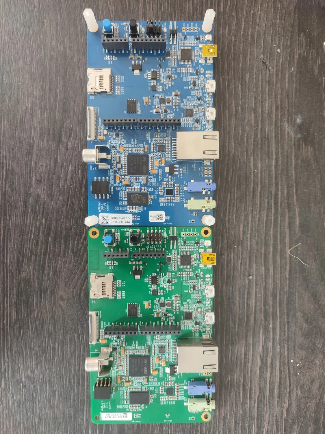

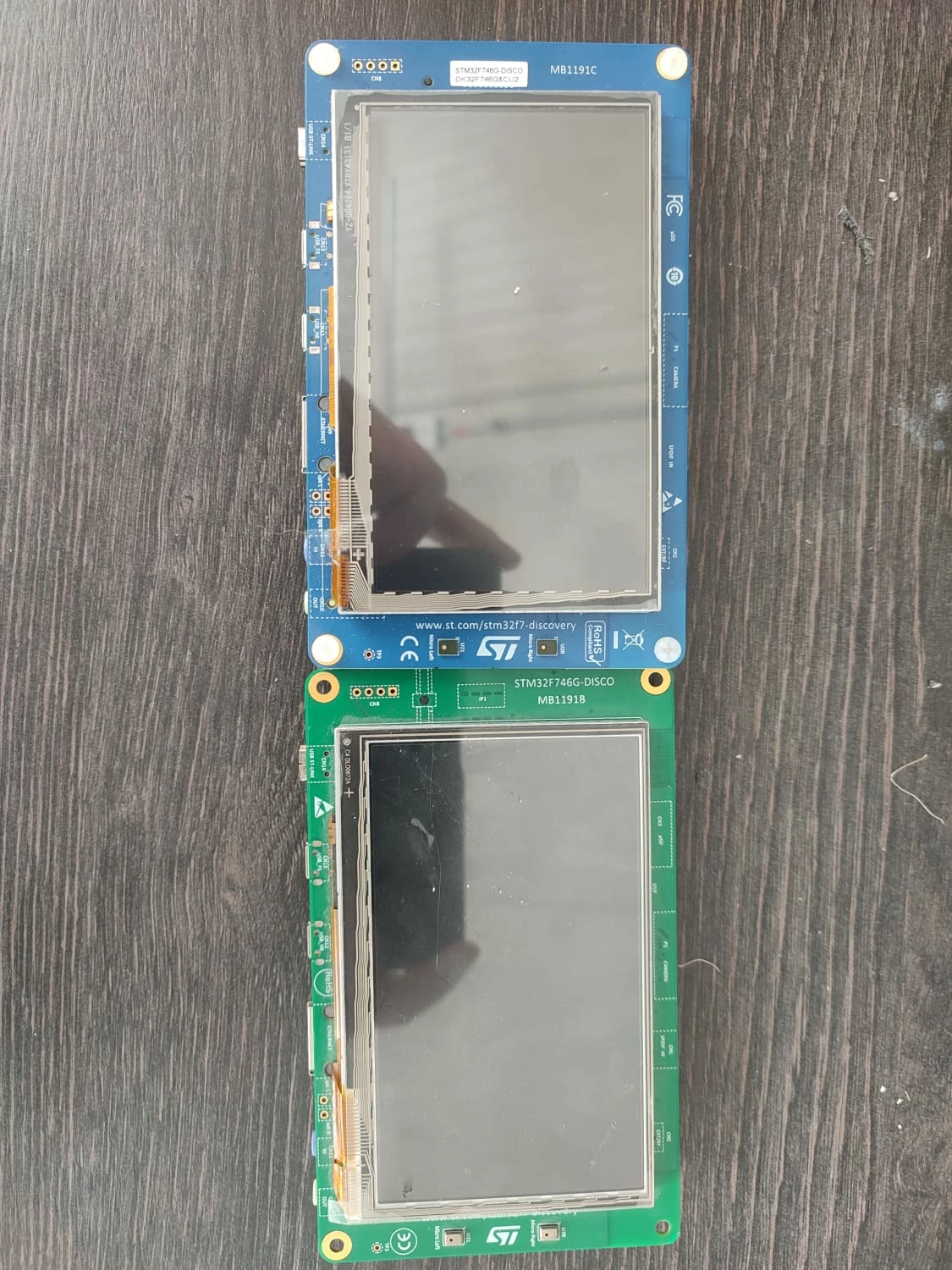

About a month ago I purchased a development pair stm32f746g-disco /mb1191c/dk32f746g$cu2 for a project in a development lab. I recommended this product because I have this same motherboard, but reference stm32f746g-disk /mb1191b and it has always worked very well for me. However, after being programmed the new board does not work correctly, I say this because nothing happens when navigating between the different windows, but the information that was programmed in the main window is correct and fluid.
I am sharing some images of the card that belongs to me (green) and the screen purchased for the project in question (blue) for you to buy. the IDE version I'm working with is STM32CubeIDE 1.8.0 and TouchGFX 4.21.1

Hi @JSarmientoA ,
I'm coming back to this very old case where I assume it is no more up to date.
But I believe that it is important to keep you and other community members informed about any related information: root cause of faced issue should be different board revisions.
Differences between revisions are added in latest UM1907 update, precisely the table "Board revision history":
