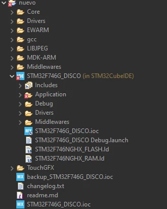

I got a problem when saving a TouchGFX project and open it with the CubeIDE.
The first time I opened a proyect from TouchGFX with the CubeIDE, it looked like this.

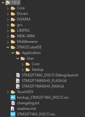

But then, when I do new proyects they look like this.
 I can't do anything and I tried uninstalling both programs and reinstalling them but It does nothing.
I really need help.

Feb 3, 2024 5:48 PM UTC
Hello
I think your problem is caused the fact that CubeIDE cannot handle properly two project with same name. (This case it seem to be STM32F746G_DISCO)
Simplest solution is to delete first other project from workspace and then import the new one.
Other solution is manually rename the .project file and its content.

Feb 3, 2024 6:18 PM UTC
Thanks man, as you said, the name was the problem. I delete the others and made a new one and it worked.
