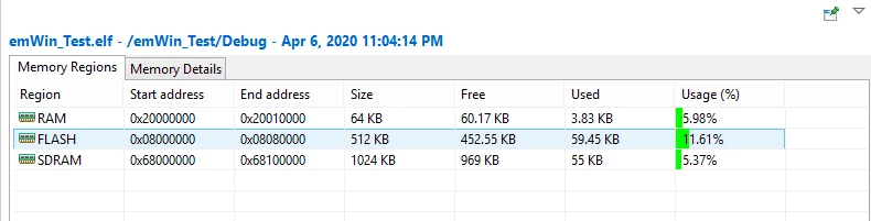

build analyzer tool of cubeide shows memory usage as follows:
in this case program run GUI_Init() function successfully and memory allocation and LCD initialization are done, (The LCD is turn to black after GUI_Init() Execution just like when i use the internal RAM as gui memory) but nothing else happens.

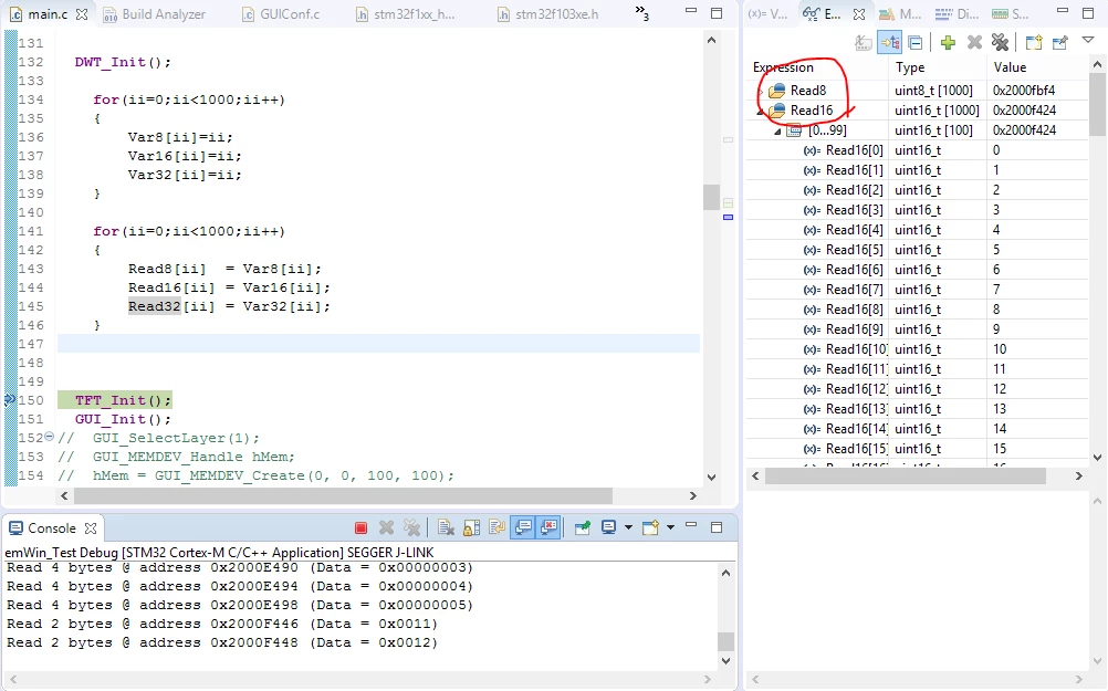

yes, I checked that through this code:
int main()
// some codes
	uint8_t static Var8[1000]__attribute__((section(".GUI_RAM")));
	uint16_t static Var16[1000]__attribute__((section(".GUI_RAM")));
	uint32_t static Var32[1000]__attribute__((section(".GUI_RAM")));
	uint8_t Read8[1000];
	uint16_t Read16[1000];
	uint32_t Read32[1000];
// other codes
	for(ii=0;ii<1000;ii++)
		Var8[ii]=ii;
		Var16[ii]=ii;
		Var32[ii]=ii;
		Read8[ii] = Var8[ii];
		Read16[ii] = Var16[ii];
		Read32[ii] = Var32[ii];
// break point here
// codes ...
I could read back the all content of the Var8,Var16 and Var32. as follows:

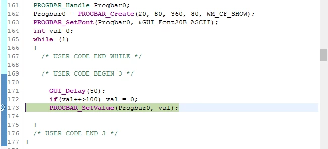

No, program continues to execution as normal but nothing displays on the screen
>>..Where does the code go in the "nothing happening" path
program is in the while loop as follows:
I placed break point inside the while(1) to making sure that program is running.
By the way, the same code runs very well with internal RAM.
