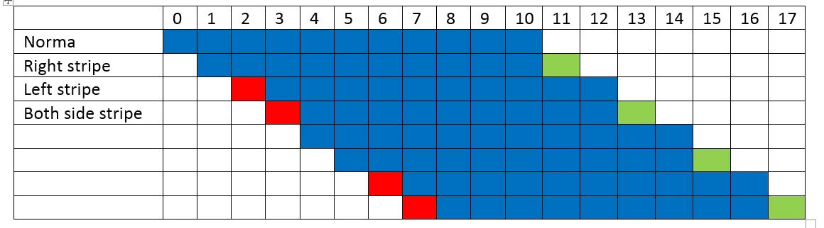

I try tp draw blue rectangle an I get color stripes - red at right and at green at the left sides of pictures or rectangles.
The appearance of artifacts depends on the coordinates of the beginning and end of the lines.
If end coordinate of line is even - no artifact. If end coordinate of line is odd - green stripe
If begin coordinate is 0 and 1, or 4 and 5, or 8 and 9 - there is no artifacts
If begin coordinate is 2 and 3, or 6 and 7, or 1 and 1 - I get red stripe at the left side
