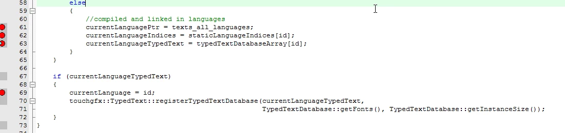

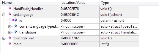

Hello!
I have homemade board with STM32F746, memory - n25q128.
Project generated by Cube 5.5 and touchGFXDesigner 4.13
IDE - KEil 5.29
I put one button to main screen.
When I put images to internal flash - all works very well.
But when I put it to QSPI - I get HardFault, with this callstack
SCT file for External memory :

IMPORTANT!!!! QSPI functions a tested, and works well. I have read QSPI DATA with special function - it contains correct data (I compare bytes in this

What's wrong?

system go to HardFault after string "currentLanguageTypedText=typedTextDatabaseArray[id]; "
February 13, 2020
Problem solved.
I forgot to enable MemoryMapped Mode.
I have enable it and program works
