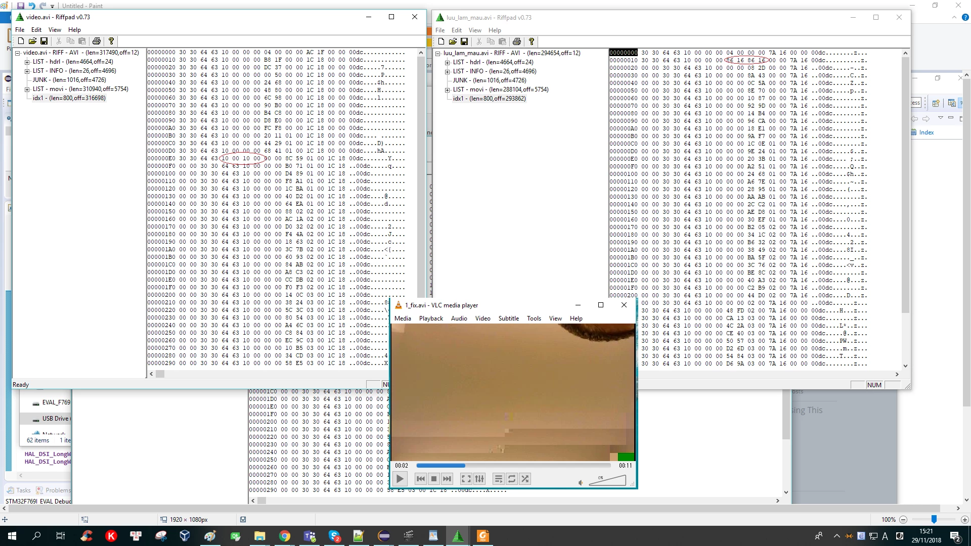

I have a problem with my code. I'm trying to write a program to take picture from camera and save it as motion jpeg video (MJPEG) in to USB, using JPEG encoder. I build already the header and the structure of MJPEG file but it had problem when I try to run that video file. Also by the source code was provided by STM, I finished to create the JPEG file.
This link below simply show some information about MJPEG construction https://blog.goo.ne.jp/sirius506/e/442f430a1531c018a32471f1ecd4ae77
I had checked and found out that the output data of frames and the idx1 is written by f_write was incorrect. Sometime 2 bytes were written again. Has someone told me that problem maybe is "3 bytes were dropped".
The header data I wrote to the begin of file is always right, but the data that I wrote to frame place and idx1 place usually has problem.
Ex: I want to write data like this below
01 02 03 04 05
01 02 03 04 05
01 02 03 04 05
01 02 03 04 05
but the output was like this
01 02 03 04 05
*01 02 01 02* 03
04 05 01 02 03
04 05 01 02 03
I had tried to change many way like make it slow (fps = 1 or 2) or change the parameter of f_write function , but it still error.

I opened my MJPEG (avi) file by RIFF pad and it show me that the header was written into this output file is completely okay.
Best answer by mthanh2602
Yes, I'm writing data to USB. 1 VGA frame around 1.5kbyte.
But good news is I had fixed my problem. The max define buffer of f_write is 512. It's okay when I increase this value to 1024 but not effective with 2048 and 4096. So I divided a big data i want to write to many smaller 512 byte packages and write it to USB. No problems happened and the AVI file run completely good. But the frame rate still slow and now I'm try to increase it.
Many thanks for your help.
