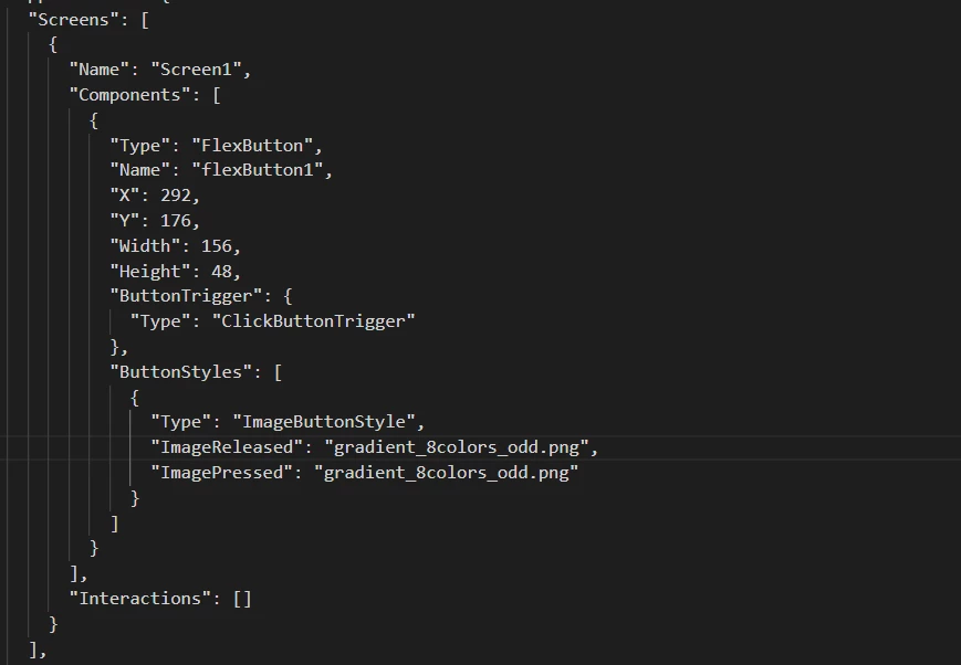

I'm trying to use images through the flex button, but, when i select some images, there isn't any visual update and selection update. I tried change the "released" image and continuous with "No image" after the selection in my library images.
anyone know about this problem?

Hello @FDigi​,
That's indeed a bug, I will report it to my colleagues.
In the meantime, a work-around could be to open your .touchgfx file and modify the ButtonStyles>ImageReleased and ButtonStyles>ImagePressed paths, in order to insert the name of your image there. That will force TouchGFX to use your image, like this :

I have tested in 4.21.0 and the problem didn't occurs.
4.21.0 -> Flex Button without problem
4.21.1 -> Flex Button without problem
4.21.2 -> Flex Button with problem
4.21.3 -> Flex Button with problem

@Romain DIELEMAN​  when you create new flex button and try change the "visual Elements" with new image choosing a image for "released" state and "pressed" state, this component doesn't change the image through the designer software and after compilation in a board, but @Yoann KLEIN​ answered about the alternative for temporarly solution.
@Yoann KLEIN​ thanks for the solution, i will use like this for for now until a new version of TouchGFX is released.
