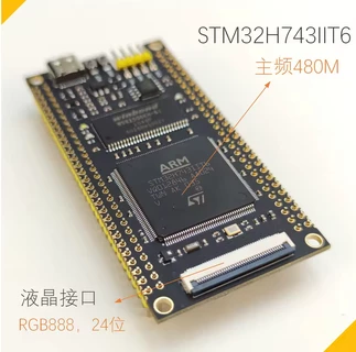

Problem with DMA on STM32H743IIT6 + IS42S16160J + lcd 800x480 module
environment
STM32H743IIT6   FK743M2-IIT6
SRAM IS42S16160J  External 16-bit 32M byte SDRAM
External QSPI driver W25Q64

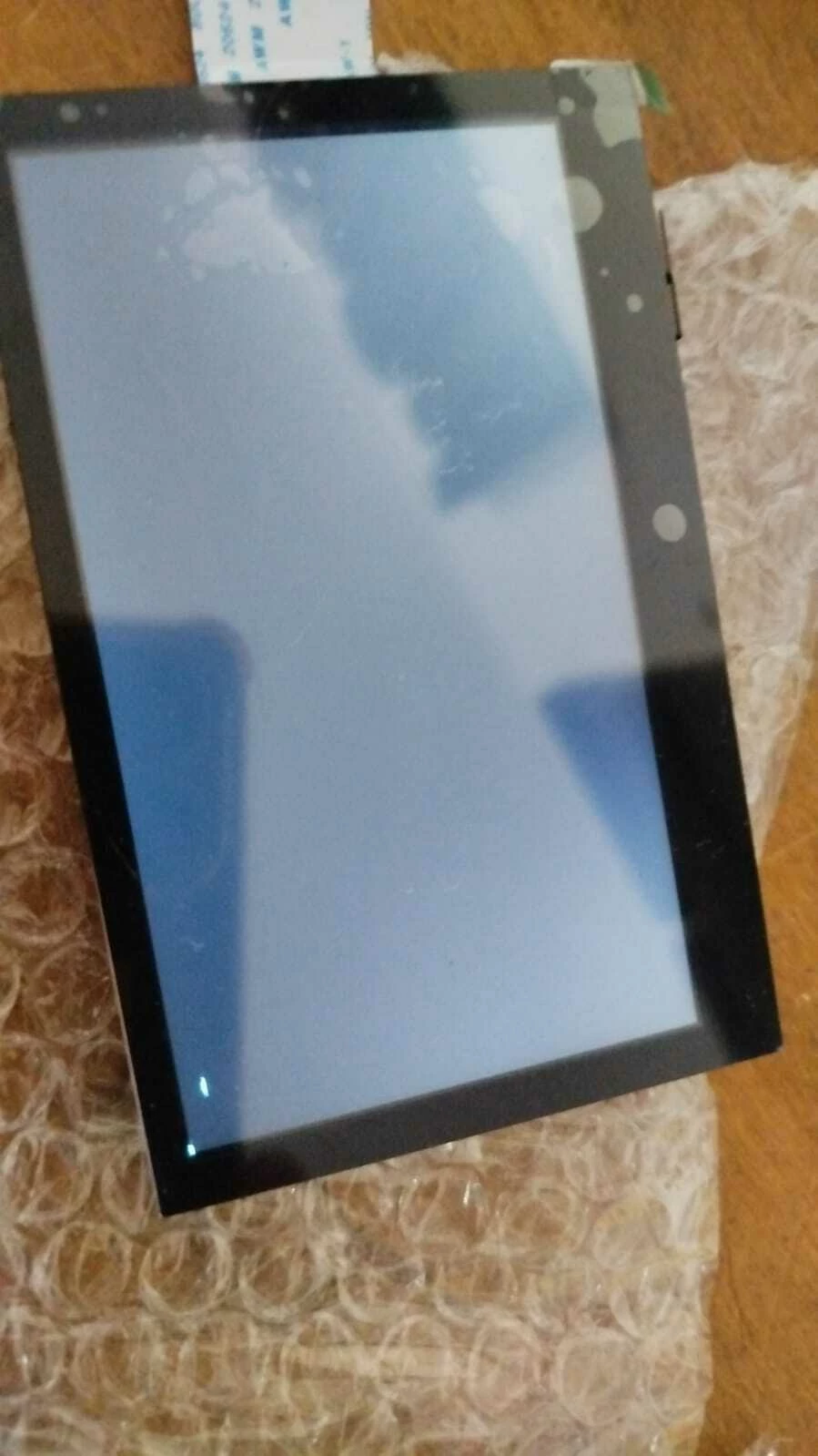

LCD 4.3”  RGB043M2-800*480*VI1.2
I have 2 problems with this module
  1. if I write a line on line y = 0 ok but if y = 10 see wrong lcd output with many pixels blink
  2. if I use the DMA to write on lcd no output
If I use 0x24000000 instead of 0xC0000000 like FRAMEBUFFER_ADDRESS both lines are ok but the 0x24000000 address cannot be used to fill oll the 800x480 lcb area
Consider that this
BSP_LCD_Clear() is able to fill alll the lcd area without problems.

#define HBP 80
#define VBP 40
#define HSW 1
#define VSW 1
#define HFP 190
#define VFP 22
#define LCD_Width 800
#define LCD_Height 480
#define LCD_Pixels 800*480
//#define LCD_MemoryAdd 0xD0000000
hltdc.Init.HorizontalSync = HSW - 1;
hltdc.Init.VerticalSync = VSW -1 ;
hltdc.Init.AccumulatedHBP = HBP + HSW -1;
hltdc.Init.AccumulatedVBP = VBP + VSW -1;
hltdc.Init.AccumulatedActiveW = LCD_Width + HSW + HBP -1;
hltdc.Init.AccumulatedActiveH = LCD_Height + VSW + VBP -1;
hltdc.Init.TotalWidth = LCD_Width + HSW + HBP + HFP - 1;
hltdc.Init.TotalHeigh = LCD_Height + VSW + VBP + VFP - 1;
hltdc.Init.Backcolor.Blue = 0;
hltdc.Init.Backcolor.Green = 0;
hltdc.Init.Backcolor.Red = 0;
if (HAL_LTDC_Init(&hltdc) != HAL_OK)
Error_Handler();
// Configurazione unica e pulita del Layer 0
pLayerCfg.WindowX0 = 0;
pLayerCfg.WindowX1 = LCD_Width - 1;
pLayerCfg.WindowY0 = 0;
pLayerCfg.WindowY1 = LCD_Height - 1;
pLayerCfg.PixelFormat = LTDC_PIXEL_FORMAT_RGB565;
pLayerCfg.Alpha = 255;
pLayerCfg.Alpha0 = 0;
pLayerCfg.BlendingFactor1 = LTDC_BLENDING_FACTOR1_PAxCA;
pLayerCfg.BlendingFactor2 = LTDC_BLENDING_FACTOR2_PAxCA;
pLayerCfg.FBStartAdress = FRAMEBUFFER_ADDRESS;
pLayerCfg.ImageWidth = LCD_Width;
pLayerCfg.ImageHeight = LCD_Height;
pLayerCfg.Backcolor.Blue = 0;
pLayerCfg.Backcolor.Green = 0;
pLayerCfg.Backcolor.Red = 0;
if (HAL_LTDC_ConfigLayer(&hltdc, &pLayerCfg, 0) != HAL_OK)
Error_Handler();
static void SDRAM_Initialization_Sequence(SDRAM_HandleTypeDef *hsdram)
FMC_SDRAM_CommandTypeDef Command = {0};
// 1. Clock Enable Command
Command.CommandMode = FMC_SDRAM_CMD_CLK_ENABLE;
Command.CommandTarget = FMC_SDRAM_CMD_TARGET_BANK1;
Command.AutoRefreshNumber = 1;
Command.ModeRegisterDefinition = 0;
HAL_SDRAM_SendCommand(hsdram, &Command, 0xFFFF);
HAL_Delay(2);
// 2. Precharge All Command
Command.CommandMode = FMC_SDRAM_CMD_PALL;
// 3. Auto-Refresh Command (8 cicli)
Command.CommandMode = FMC_SDRAM_CMD_AUTOREFRESH_MODE;
Command.AutoRefreshNumber = 8;
// 4. Load Mode Register (0x220 = CAS 2, Burst Length 1, Sequential)
Command.CommandMode = FMC_SDRAM_CMD_LOAD_MODE;
Command.ModeRegisterDefinition = 0x220;
// 5. Program Refresh Rate
HAL_SDRAM_ProgramRefreshRate(hsdram, 1386);
static void MX_FMC_Init(void)
FMC_SDRAM_TimingTypeDef SdramTiming = {0};
hsdram1.Instance = FMC_SDRAM_DEVICE;
hsdram1.Init.SDBank = FMC_SDRAM_BANK1;
// Corretto per W9825G6KH (32MB): 9 bit colonna, 13 bit riga
hsdram1.Init.ColumnBitsNumber = FMC_SDRAM_COLUMN_BITS_NUM_9;
hsdram1.Init.RowBitsNumber = FMC_SDRAM_ROW_BITS_NUM_13; // <-- CORRETTO A 13
hsdram1.Init.MemoryDataWidth = FMC_SDRAM_MEM_BUS_WIDTH_16;
hsdram1.Init.InternalBankNumber = FMC_SDRAM_INTERN_BANKS_NUM_4;
hsdram1.Init.CASLatency = FMC_SDRAM_CAS_LATENCY_2;
hsdram1.Init.WriteProtection = FMC_SDRAM_WRITE_PROTECTION_DISABLE;
hsdram1.Init.SDClockPeriod = FMC_SDRAM_CLOCK_PERIOD_3;
hsdram1.Init.ReadBurst = FMC_SDRAM_RBURST_ENABLE;
hsdram1.Init.ReadPipeDelay = FMC_SDRAM_RPIPE_DELAY_1; // ex 2
SdramTiming.LoadToActiveDelay = 2;
SdramTiming.ExitSelfRefreshDelay = 7;
SdramTiming.SelfRefreshTime = 4;
SdramTiming.RowCycleDelay = 7;
SdramTiming.WriteRecoveryTime = 3;
SdramTiming.RPDelay = 2;
SdramTiming.RCDDelay = 2;
if (HAL_SDRAM_Init(&hsdram1, &SdramTiming) != HAL_OK)
Error_Handler();
SDRAM_Initialization_Sequence(&hsdram1);
static void MX_DMA2D_Init(void)
hdma2d.Instance = DMA2D;
hdma2d.Init.Mode = DMA2D_M2M;
//hdma2d.Init.ColorMode = DMA2D_OUTPUT_ARGB8888;
hdma2d.Init.ColorMode = DMA2D_OUTPUT_RGB565;
hdma2d.Init.OutputOffset = 0;
// Configura il Layer 0 per corrispondere al Layer LTDC attivo
hdma2d.LayerCfg[0].InputOffset = 0;
//hdma2d.LayerCfg[0].InputColorMode = DMA2D_INPUT_ARGB8888;
hdma2d.LayerCfg[0].InputColorMode = DMA2D_INPUT_RGB565;
hdma2d.LayerCfg[0].AlphaMode = DMA2D_NO_MODIF_ALPHA;
hdma2d.LayerCfg[0].InputAlpha = 0;
if (HAL_DMA2D_Init(&hdma2d) != HAL_OK)
Error_Handler();
if (HAL_DMA2D_ConfigLayer(&hdma2d, 0) != HAL_OK) // <-- Modificato a 0
Error_Handler();
