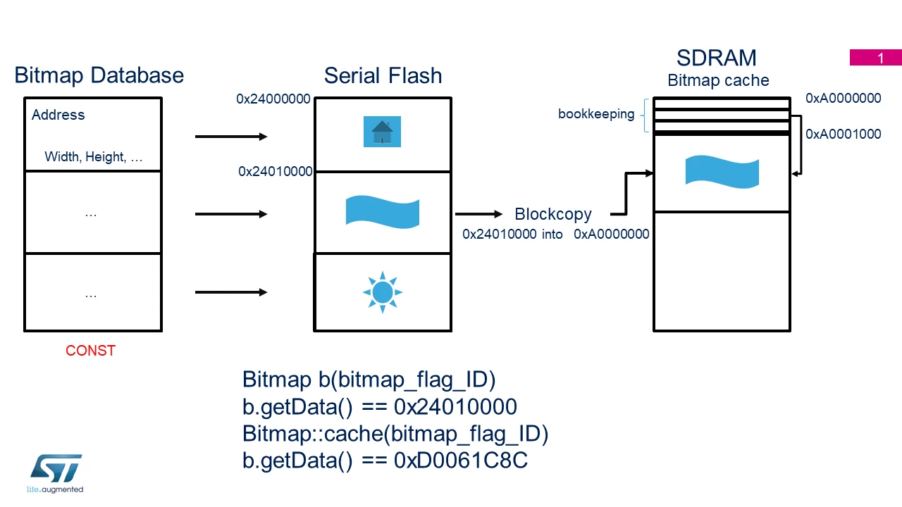

Best answer by Romain DIELEMAN
The bitmap database is "constant", the cache functions do not interact directly with it. When the programmer requests a bitmap to be cached, TouchGFX finds the address of the bitmap in the flash and copies data from here. I've made a very very poorly done schematic of the process.
("getData" returns a pointer to the Bitmap data, this is just to show you that when you cache a bitmap, TouchGFX copies the pixels from the original location to the bitmap cache using the BlockCopy  function you wrote.)
Could you maybe share your custom code? I'd like to help and understand where the tearing comes from.
The 524 bytes in your case are actually a table of arrays used for bookeeping/know which bitmap is cached. I will also try to deliver a simple demo using the F429I disco board and bitmap caching if I can (and a better drawn explanation).

Romain DIELEMAN
Romain DIELEMANBest answer
May 12, 2020
Kpodu.1
Kpodu.1Author
May 12, 2020
Hi Romain,
First of all I just want to thank you very much for helping me.
Your graphic is good. It cleared my understanding.
I understand the bitmap_database is constant. but when I meant bitmap database I mean some fictional internal array which touch gfx uses.
After I did cache all. when I do the b.getData(). I am getting the new cached address. But still the image dont appear on the screen. I strong feeling is still it is looking in the old location.
