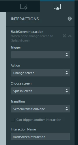

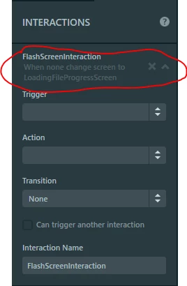

I'm facing problems when I try to port a 4.9.3 project to 4.12.3.
  • First, I have many places in the original 4.9.3 designer project that I defined a change screen interaction with no trigger, I then use it in the code when I want to switch screens. When I open the ported 4.12.3 project those interactions have the action field empty even thought the interaction header still "remember" the original action. (See attached screen shoots)

Hi Eyal,
This issue has already been fixed in the upcoming 4.13.0. For the "Change screen" action, in particular, the designer won't display it across switching screens in the designer, and as you have experienced, also during import. In your case this will cause compilation errors because the "goto"-methods won't get generated. So you'll have to redo this configuration manually for this import and be aware that you may "lose" the change screen action when changing screens in the designer, but the code is still generated.
Thanks for the report!

Thanks Martin,
Two things:
  1. What do you mean by "redo this configuration manually for this import "? Can you elaborate?

  1. By "redo" i mean, configure your "change-screen"-interactions in 4.12.3 as they were in 4.9.3 (To get back your generated goto methods).
  2. In 4.12.3 you need to "Generate" code manually in order to get all of TouchGFX bootstrapped to your application. Some of these errors seem like they may be related to the fact that you are simply not compiling all necessary files. Give that a try and let me know.
