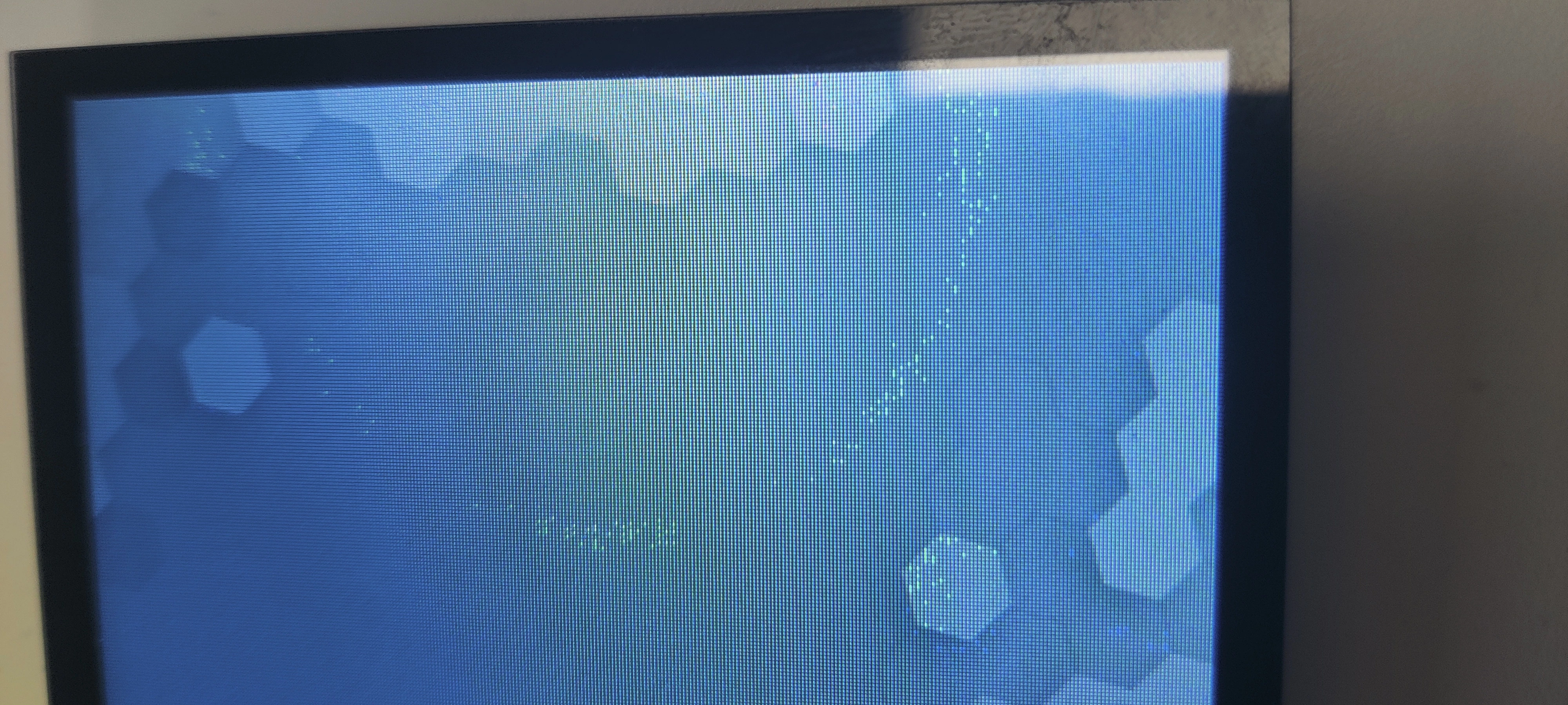

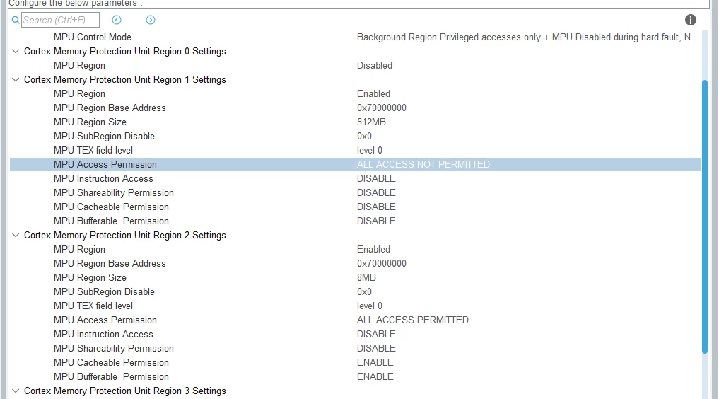

I have made a custom project with STM32H735IGT. I use Touchgfx.
I am using external flash and external RAM. The problem is when I place the framebuffer in external RAM. Some green pixels appear as in image 1. When I place the framebuffer in internal RAM, the image is painted well.
I am using IS66WVH16M8DBLL-100B1LI RAM. I attached hardware configuration, the RAM is OCTOSPI2.
video of the problem and .ioc:
Where is the problem?

Hi @fernandogamax,
Have you tried with lower OCTOSPI Clock frequency? It seems you have already exceeded the max frequency as detailed in datasheet. Could explain the use of the MPU configuration for SRAM region (0x30000000)?
To give better visibility on the answered topics, please click on "Best answer" on the reply which solved your issue or answered your question.Best regards,FBL
I use that section of RAM to place some buffers that will be sent by DMAUART. And I read in the community that to do it, I had to configure the MPU region.

hi, this is not a read/write problem in RAM, if you look at your problem you realize that the green pixels are positioned circularly on a shade of the image, therefore typical of a particular color. I believe that you have some problem on the LTDC transmission line of the display or from the RAM to the micro, and that it concerns the low bits of the line itself. Probably the RAM line since the problem is not found on the LTDC when internal..
Msolinas
Senior
Sep 20, 2023 12:08 PM UTC
mmm if you put the bitmap in the internal flash and you have the same effect, then it's useless to search on the octospi... without the external RAM everything is perfect, then it's the RAM. Very strange over some colors. I think only can be hardware line frequency problem or DMA data corruption.

You have PB8 LTDC_B6 and PB9 LTDC_B7 in fast mode disable in LTDC, why? this is blue region of color, exactly your problem
Sep 20, 2023 12:32 PM UTC
I have checked GPIO_SPEED_FREQ_VERY_HIGH, all are fine.
PB8 LTDC_B6 and PB9 LTDC_B7 I have put them in fast mode, without any change

Hi fernando, you do not set MPU, the MPU is very important for RAM settings.
This configuration is copied from the example project of the evaluation board (STM32H735G-DK). However, I have tried to change it, but it does not solve the problem.

Could be caching issue with external RAM. Yes, you should configure the MPU, but to test if that is the issue at all, disable caching for the whole system. Test. If the colors are still there, it isn't the MPU configuration.
Sep 25, 2023 10:19 AM UTC
I have already performed those tests, everything remains the same.

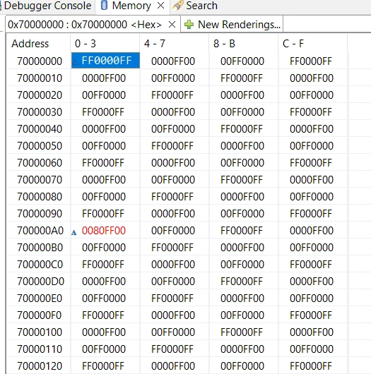

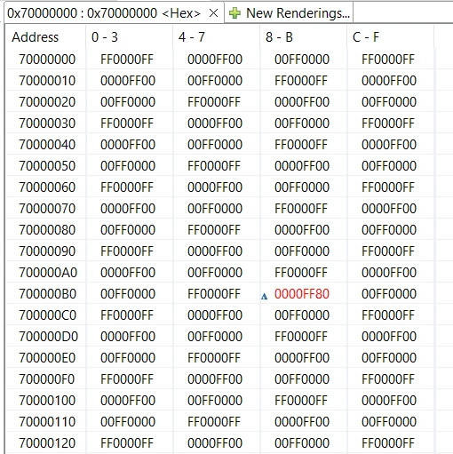

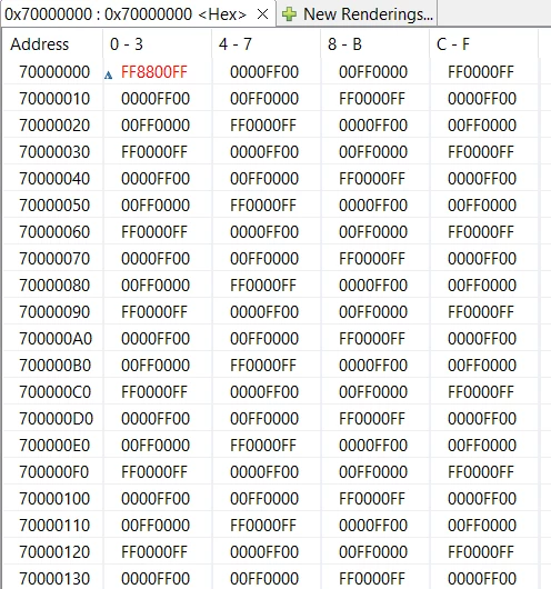

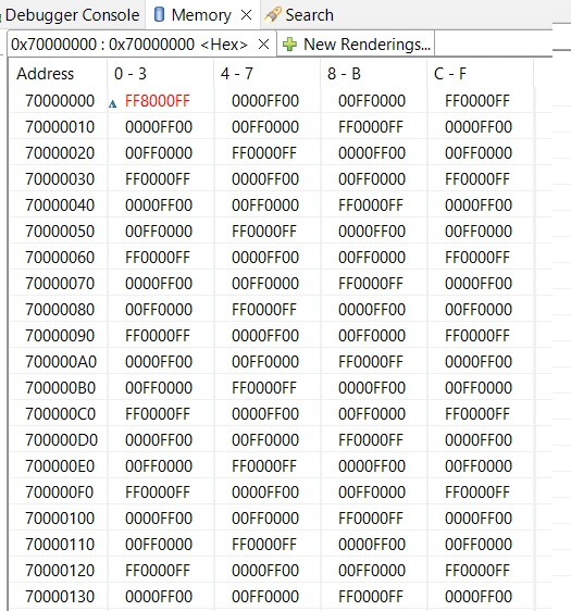

I have done more tests.
I have placed the screen all Blue. In debugging I have been looking at the external RAM, and I could see the following errors. And they repeat.
Any idea why that could be?

Sep 25, 2023 3:38 PM UTC
Try direct write to problem place.
*(0x70000000) = 0x....
and better big rectangle write from c code , not from touchgfx render.
Sep 25, 2023 4:02 PM UTC
I can write without problem 0x70000000
I have tried with resistance of 0, and resistance of 33

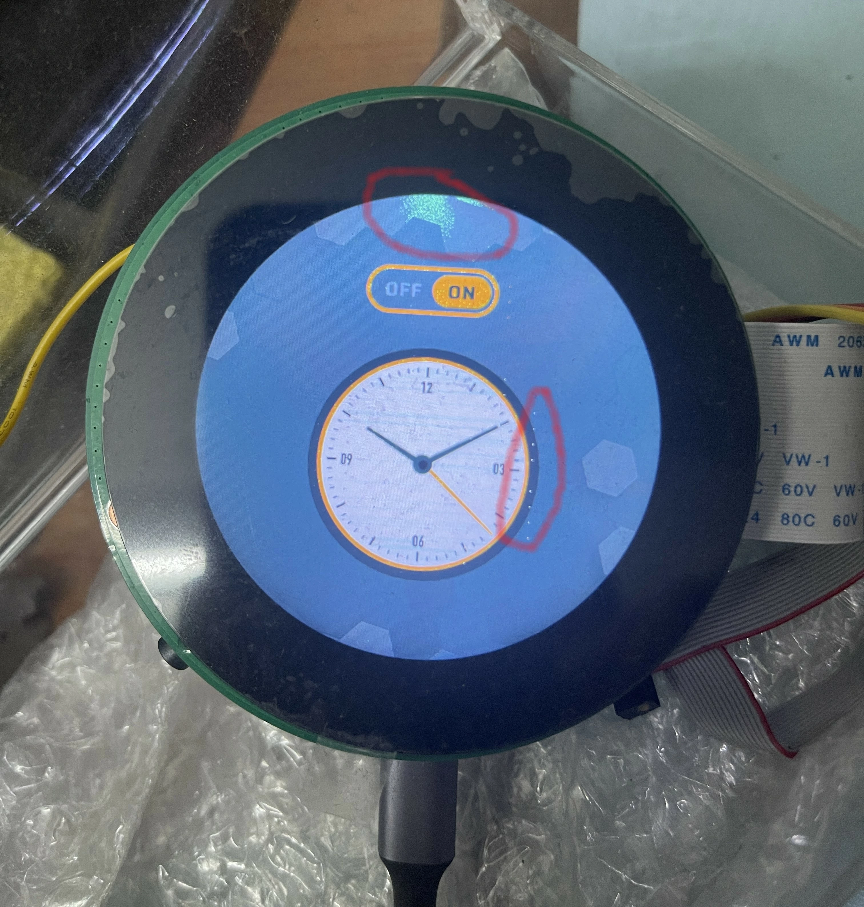

Hello @fernandogamax
I'm also having the same problem as you. I used STM32H723ZGT6, OSPI PSRAM APS12808L-3OBM, LCD RGB666 LTDC. The image always display noisy green pixels (see image).
My custom board is layout with 2 layers, RAM wires is same length, but I don't add any resistor on any wire (CLK, DQS, DQ0..7). Would adding a 120 ohm resistor on CLK solve the above problem? (Because of budget and time issues, I don't want have to re-layout the circuit board with 4 layers)
Thank you so much.
