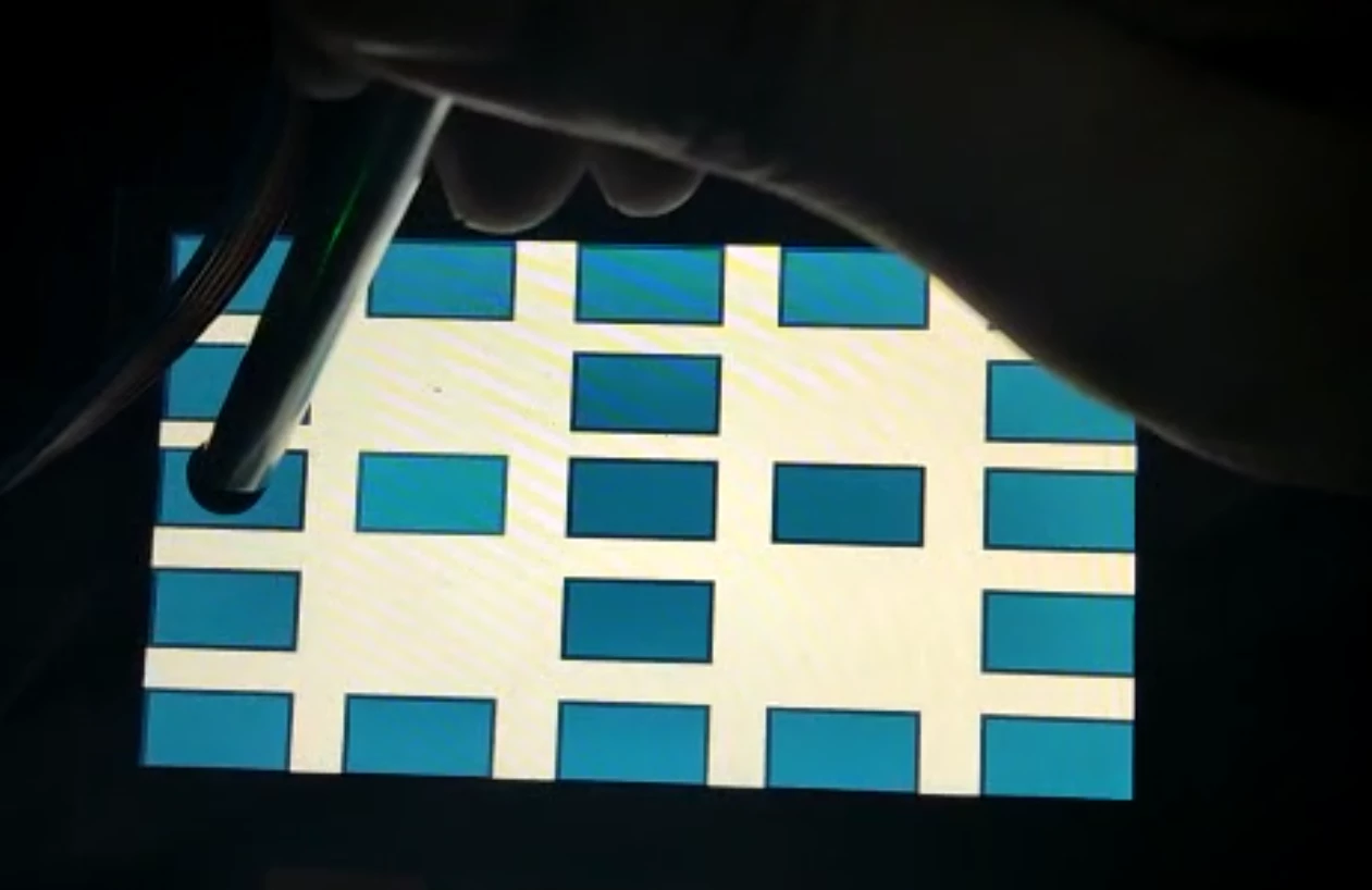

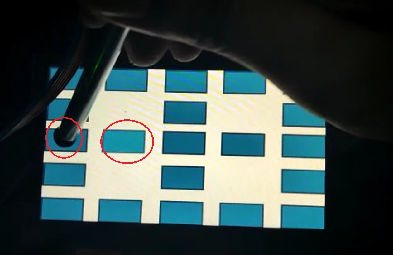

I'm using a custom board stm32f469IIT , using a PS043BWSA03 LCD (RGB888) using the touchgfx library and STM32touchcontroller (LTDC RGB565). there is a problem when reading the touchscreen axis (example in photo). is there a solution?0693W00000NsrYkQAJ.png0693W00000NsrZQQAZ.png

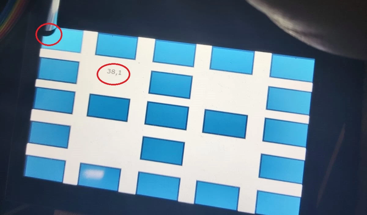

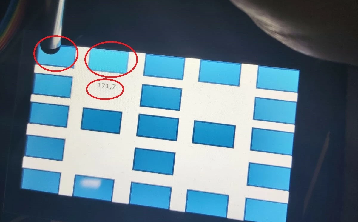

thanks for the information, I've tried on the simulator and tried to output the axis value data. here is an example, there is a jump in the value of the axis after I check. on testing point 1 the first image of the axis read is correct but on testing at point 2 there is a jump in value(see photo)0693W00000NsurQQAR.jpg0693W00000Nsur1QAB.jpg
DPutr.1
DPutr.1Author
Jun 28, 2022 9:18 AM UTC
sorry i forgot to give a description, the displayed value is x,y

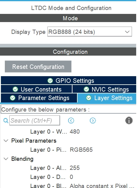

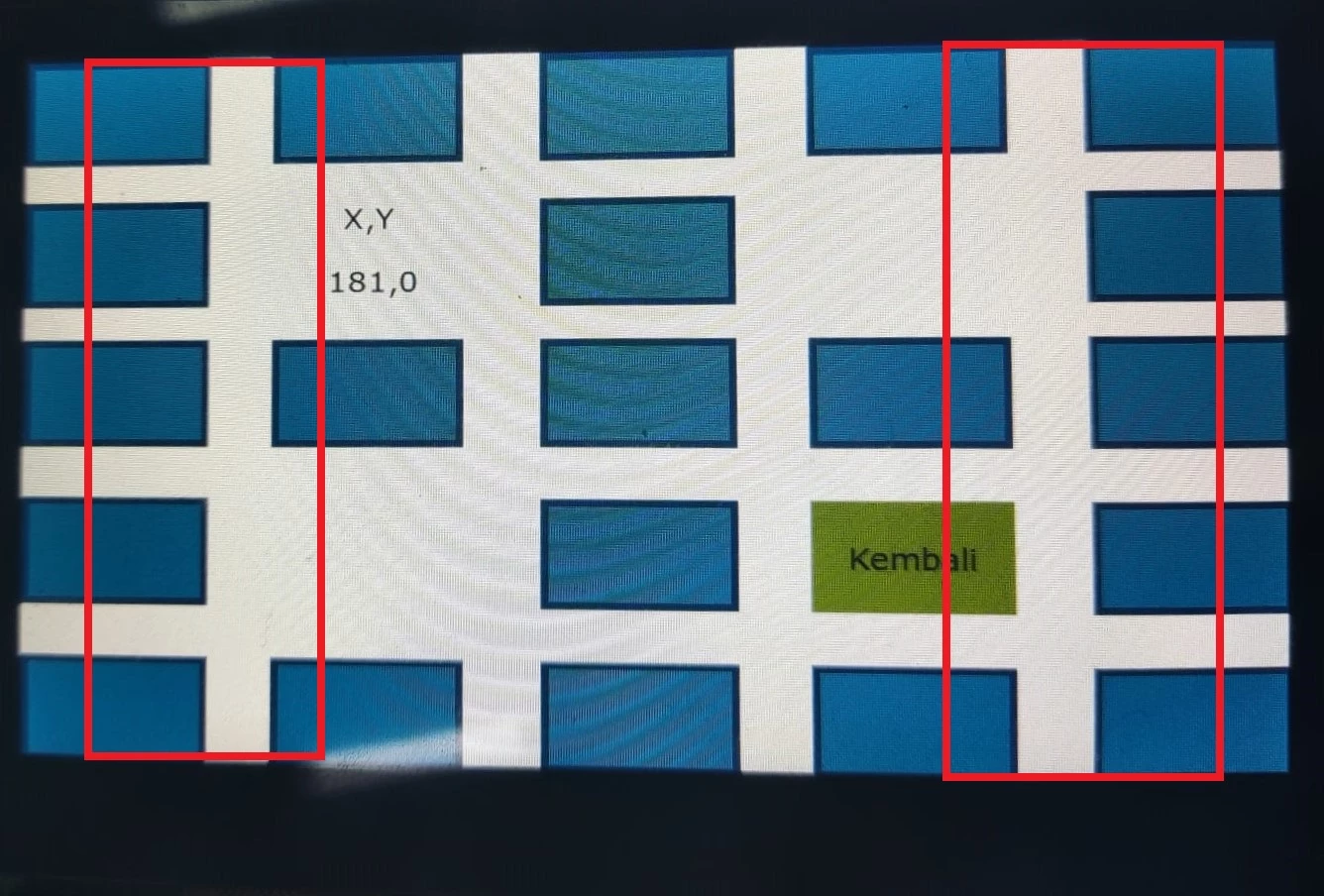

0693W00000Nsv5hQAB.png0693W00000Nsv3bQAB.jpgAfter I checked all the screens, here's the part that's the problem. does converting from RGB888(LCD) to RGB565(.ioc) have any effect?
MM..1
Jun 28, 2022 11:09 AM UTC
Touchcontroller driver code how from where ? And No - color mode on LCD isnt relevant to touch .
