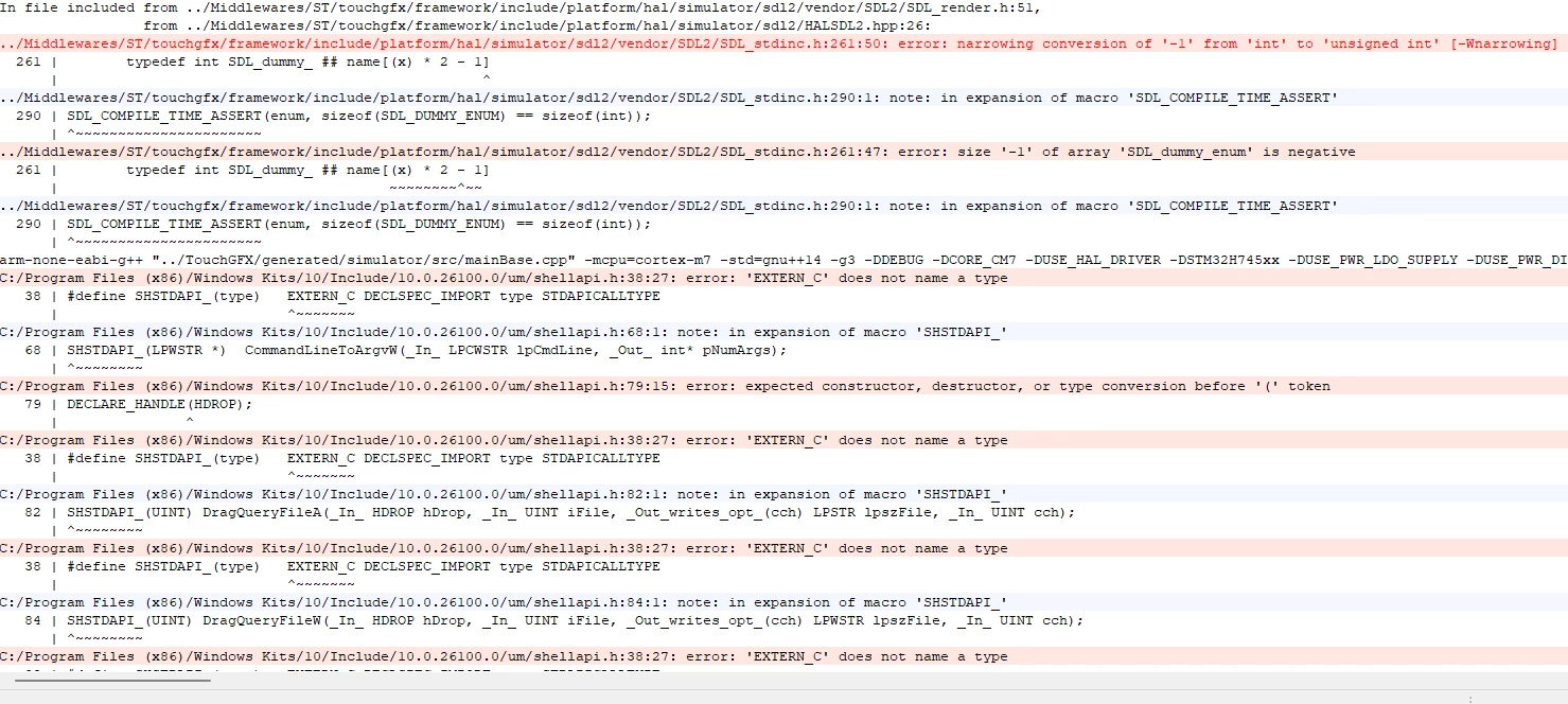

Feb 10, 2025 1:13 PM UTC
Helllo @GaetanGodart ,
Thank you so much for responding on my post.
After i included all the missing paths now i got below errors.
any help would be great. Thanks
GaetanGodart
Feb 18, 2025 9:25 AM UTC
Hello @bbasnet ,
You should not have any error on code from the framework.
Also, it is weird that the other errors are from a file in windows, not TouchGFX.
Did you change your default compiler or something similar that could cause framework functions to not compile properly and to force the use of some windows file instead of TouchGFX files?
Regrads,
Gaetan GodartSoftware engineer at ST (TouchGFX)
