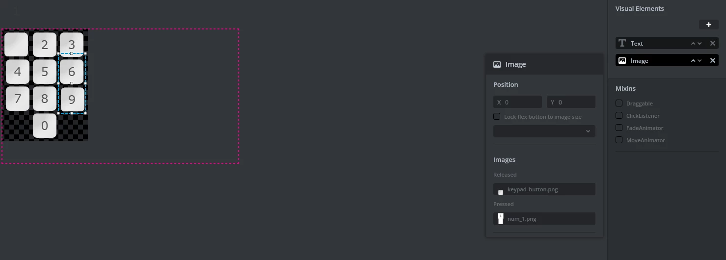

Pressed button image
Is it possible to use bigger pressed button image than released button image? How can I achieve it?0693W00000UnwIaQAJ.png

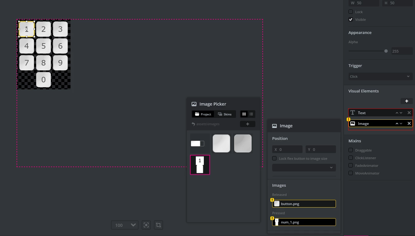

Hello heyo,
Your two images needs to have the same size. If you don't have the same image size, you can create a new image with the dimension of your biggest image, paste your small image inside it, and fill the remaining area with transparency.

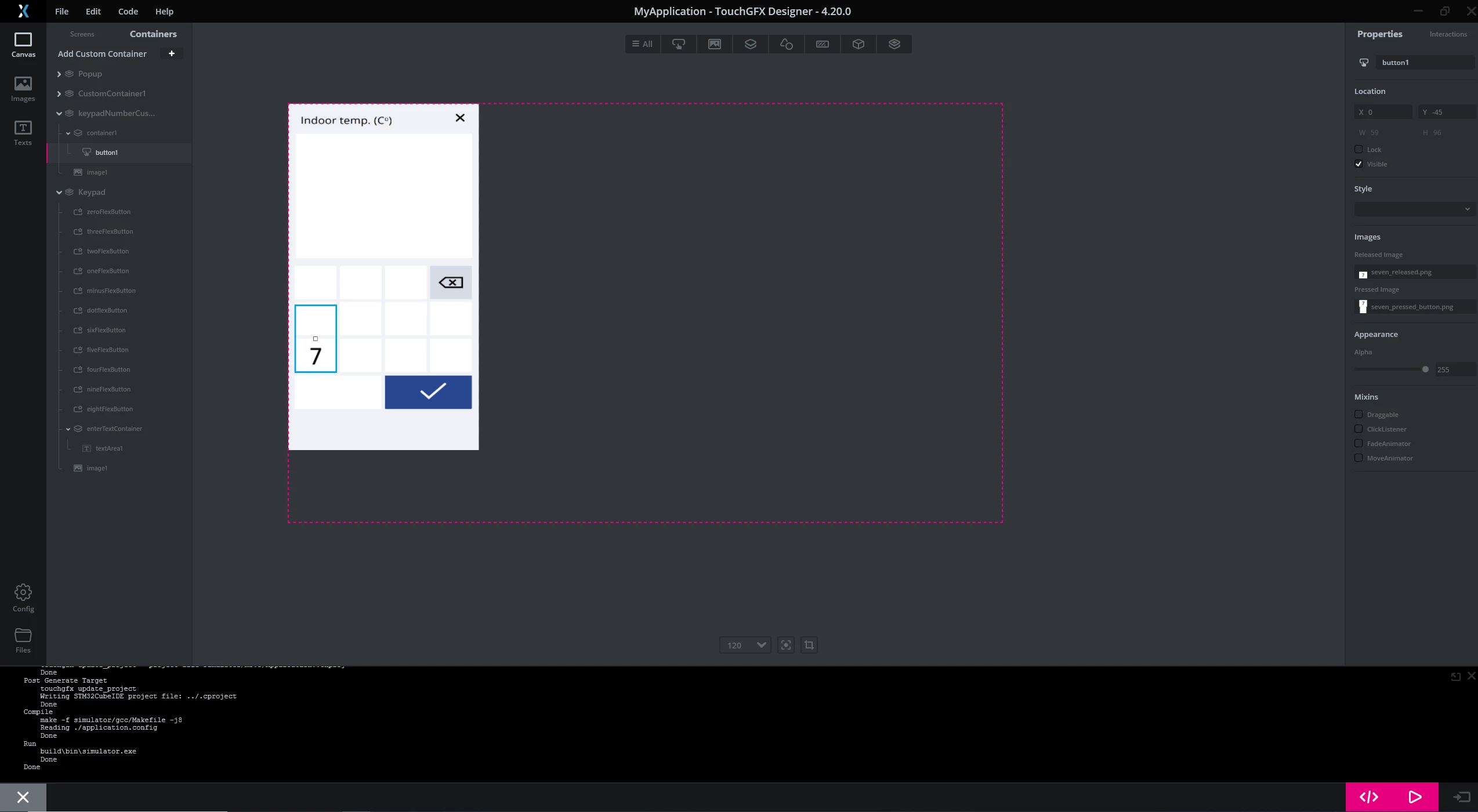

I set button like this:0693W00000Uo3ELQAZ.pngPressed button shows how I want:
0693W00000Uo3FJQAZ.png But there is problem. I can't touch "6" button because "9" touch button area goes on "6"

@Osman SOYKURT​  Hello again,
I have another problem. I do everything as you said but this happen:0693W00000Uo4arQAB.png0693W00000Uo4awQAB.png0693W00000Uo4b1QAB.png
heyo
heyoAuthor
Oct 14, 2022 11:31 AM UTC
If image size is bigger than container it does not show up. Do you have another solution?

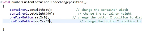

Osman SOYKURT
Oct 14, 2022 12:10 PM UTC
Yes that's normal, so you'll need to play with these functions now :
 if (button1.getPressedState() == true) // to know if we pressed the button
 container1.setWidth(container1NewWidth); // change the container width
 container1.setHeight(container1NewHeight); // change the container height
 button1.setX(button1NewXPosition); // change the button X position to display the area you want to show
 button1.setY(button1NewYPosition); // change the button Y position to display the area you want to show
 container1.invalidate();
 button1.invalidate();
/Osman

Hello @Osman SOYKURT​ . I created virtual function which calls when button is pressed and then changes containers height but nothing happens and I am sure that it fulfils function : container1.setHeight(container1NewHeight); Do you have any suggestions? Thank you.
heyo
heyoAuthor
Oct 15, 2022 3:55 PM UTC
I do like this and changes only button position : 0693W00000Uo7YtQAJ.png
