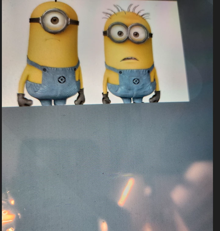

My problems with Portrait orientation don't end.
I have a very large project where changing the architecture and function calls costs much more than changing a single function.
My problem is how?
The function is readBMP24File.
In my project it is loaded from several places and many different screens.
In the original project it works very well, many images are called or even of different sizes from an MMC with fatfs.
Has anyone solved the problem of changing orientation without having to change the position and orientation of the images?
I'm starting to have serious doubts that the touchgfx gui really helps in the work I do.
If anyone can help me in solving the problem with a new or different algorithm I would be grateful.
JTP1Best answer
Graduate II
Apr 30, 2024 6:17 PM UTC
Hello
Please test the attached version. It should keep now the image same position in landscape and portrait mode (eg. rotates the image). was it what you needed ?

The project includes a USB MSC that allows me to see the fat on the MMC from the outside and upload and download the images, so yes, the images are not damaged, I can see them perfectly.
But the problem is still the same as a few posts ago.
This project works perfectly in landscape, I don't understand the reason for the malfunction in vertical. I had read on another post:
https://community.st.com/t5/stm32-mcus-touchgfx-and-gui/dynamic-bitmap-display-in-vertical-screen/td-p/220403
similar problems. Is there a decent solution?

Really strange, has anyone really had this problem? I'll post some pictures tomorrow.
JTP1Best answer
Graduate II
Hello

IT WORKS!
Thanks JTP, really thanks, everything works and does what it's supposed to.
