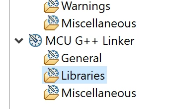

ld.exe is linker then your issue isnt include or compile.
You write project created in TGFX no IDE. This projects isnt perfect for migrate.
But my tip on new PC you place project on other folder and this corrupt library config...
