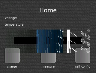

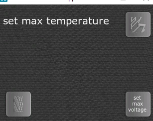

png-data does not show properly on the TouchGFX "Run Simulator"
Dear STM community and team
I'd like to try out some widget on the TouchGFX Simulator but since the png-data does not show properly on the simulation, it is difficult to do so. Any idea to resolve this problem?
I have attached some pictures of the simulation. Temperaturebar and icons on the buttons is not displayed correctly.

Sometimes i see this when images is angle 90 , try switch back to 0 generate and back to 90 generate. Me this helps. Seems as bug in touch.

Thank you very much, it worked!
