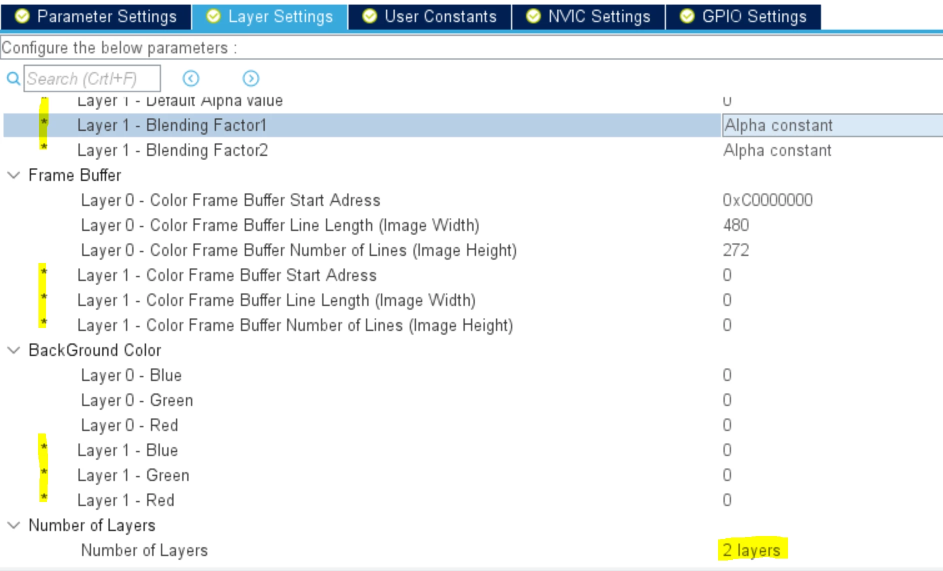

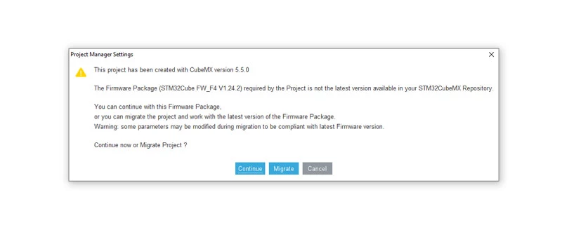

this is the error I am getting once I migrate or click continue when I open project in CubeMX 6.0 or CubeIDE 1.4 created in TouchGFX 4.14
then screen created in TouchGFX will not longer display, it just dark.

What board are you using ? Did you correctly change the TouchGFX Generator version to 4.14 in CubeMX 6.0.0 ?
Also, CubeMX 6.0.0 generates a second layer even though you do not set it. It's a CubeMX bug that will hopefully be fixed soon.
In the meantime, to change it, enable the second layer and set everything to 0 (it should already be the case but verify when enabling)
The Application Templates in the Designer are being updated to the new versions of CubeMX, CubeIDE and TouchGFX. We hope this will be available soon enough.

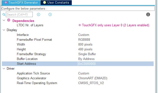

I did as you suggested and it did not work the same problem as soon as I open project in CubeIDE 1.4 the screen goes dark and this is the error I got when I changed to 2 layers I am using STM32F469 Discovery. And I have changed in Cube IDE and Cube MX to version TouchGFX 4.14
Romain DIELEMAN
August 6, 2020
The issue in your screenshot is a consequence of the 2 layer issue. It is a warning rather than an issue, you can still generate code from CubeMX.

Hello @MNapi​ ,
After some investigation, your problem might be due to NVIC priorities being reset.
Indeed, when updating to CubeMX 6.0.0, the NVIC priorities are reset because the CubeMX team made some changes regarding the priorities linked to FreeRTOS. This is a bug that is only noticeable when using FreeRTOS. If the priorities are at 0 the interrupts won't be triggered. So set the priorities of interrupts that are enabled such as LTDC or DMA to 5.
Tell me if it solves your issue.
