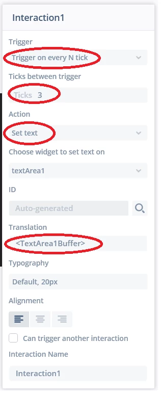

Please advise on using TextArea Set text interaction to dynamically set text.
Please note the interaction below trying to update text using the value in the buffer (not working)

Hello @ksale.1​ ,
Why not simply use Wildcards for displaying your value in the TextArea ?
That could be way more easy and you would be able to still use the Unicode::snprintf() method to achieve it.
/Yoann

I've achieved it programmatically in handleTickEvent()
void Screen1View::handleTickEvent()
	boxProgress1.setValue(flow);
	Unicode::snprintf(textArea1Buffer, TEXTAREA1_SIZE,"%u", flow);
	textArea1.invalidate();
can set text do the same?

Hello @ksale.1​ ,
/Yoann
