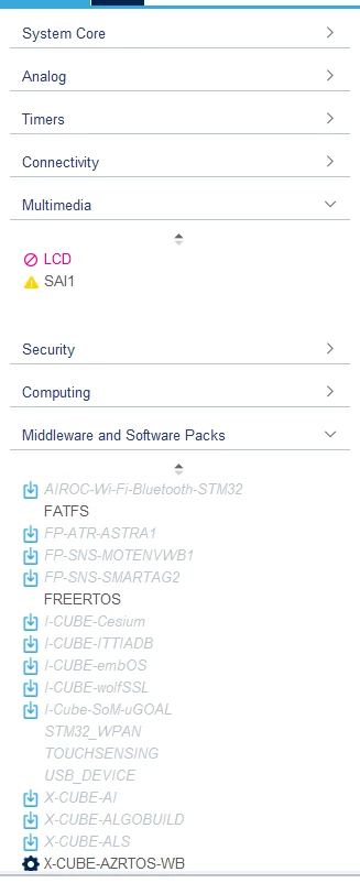

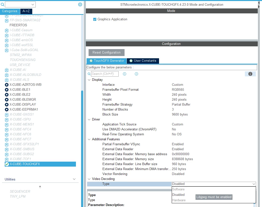

hello everyone ,i have successfully using MX+TouchGFX+IDE with my custom PCB board,and i want to add a video into my project,but i can't find "LIBJPEG" in "Middleware and Software Packs" or "JPEG" in "Multimedia",like this website:
https://support.touchgfx.com/docs/development/touchgfx-hal-development/generator-how-to/touchgfx-al-configuration/video-decoding
so how can i do?
  • MCU:stm32wb5mmg
  • LCD driver:st7789
  • Display:240x240pixels,RGB565
  • FW Package:STM32Cube FW_WB V1.18.0
  • X-CUBE-TOUCHGFX version:4.23.0

Hello @yukang ,
STM32WB5MMG is not capable of running and decoding videos, therefore, the LIBJPEG and JPEG options are not available in the STM32CubeMX project.

Dec 21, 2023 1:49 AM UTC
thank you @Mohammad MORADI ESFAHANIASL ,
I plan to use the video for startup purposes, so I'll try using animation first.
