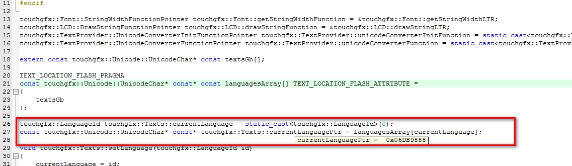

With the mapped address begin in 0x9000 0000,the Font pointer should get an adress at 0x9000 000 uper.However, the font point get the location 0x6DB 9888, not in the extera flash.
then I get a HardFault.
the same Application no using Inner Flash get the address at 0x080861C8,the it can run the GUI Demo without any question.

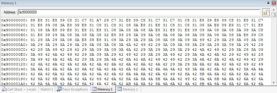

I use CubeMX 5.0 to creat my MDK project.
I use WINBOND's w25q128 for external Flash.
I think the QSPI peripheral did working cause I enable the QSPI memory Map model,when I don't use the part access area for fonts, the application can run normally.
While I usd Debug model, data in memroy mapped address at 0x9000 0000 is the same as the result when I use normal SPI operation to read.

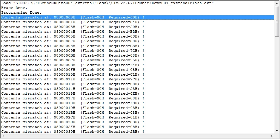

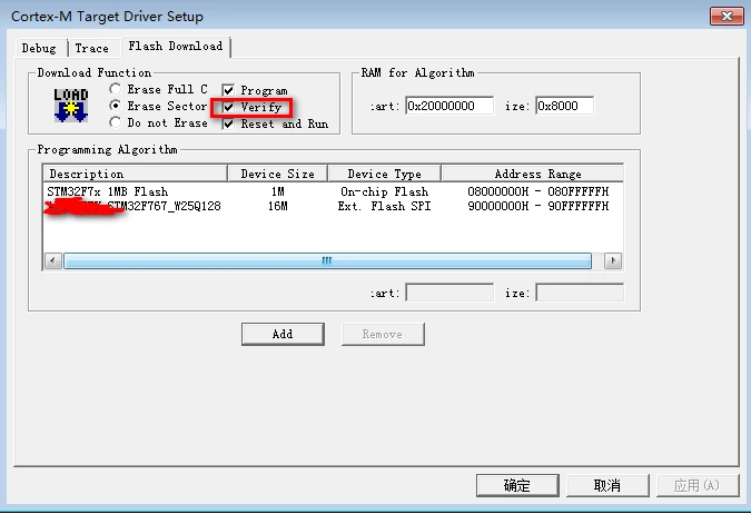

Incidentally,I write the MDK "Flash Programming" to place asserts by myself ,but some thing wrong happend .This lead to download and flash failure.
when I don't use the "verify" option,the the codes down load successfully.
