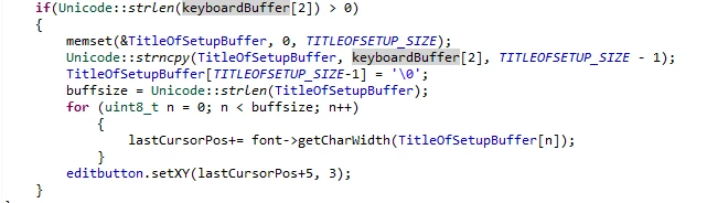

Hello everyone,
Im faced with problem. I want to save headline name typed by keyboard
This is how I copy buffer to wildcard
0693W00000WLQa5QAH.pngWhen I sent keyboard[2] to view like this:
0693W00000WLQaAQAX.pngAnd throught presenter I save string to model:
0693W00000WLQaFQAX.pngPresenter:
0693W00000WLQaUQAX.pngModel:
0693W00000WLQaoQAH.pngAnd in model I create Unicode::UnicodeChar* array like this. Am I doing this right?:
0693W00000WLQatQAH.pngWhen I store this data to model I take this info in other screen

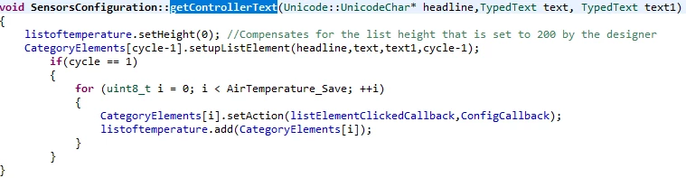

Here I take headline name and send it to getControllerText function
0693W00000WLQbNQAX.pnghere is this function:
0693W00000WLQW4QAP.pngIt is OK how I store Unicode::UnicodeChar* strings? Because when I want to save 2 strings then second string replace first one and it becomes the same. Maybe someone see the problem?
When I store one string:
0693W00000WLQcGQAX.pngThe second one replace first string and second and I didint see why..

No you dont send buff. Debug your code and will see, that in your .Headline is pointer address = kebuff[2]
You need on any transfer stage create strcpy.
Unicode | TouchGFX Documentation
and remove * from Unicode::UnicodeChar in struct

I mean no. You send over presenter pointer into keyboard buff and this stay one.

AMM, but I send keyboard buff over presenter to model and store them into array.
