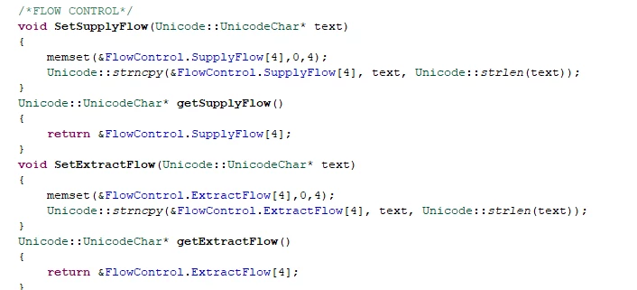

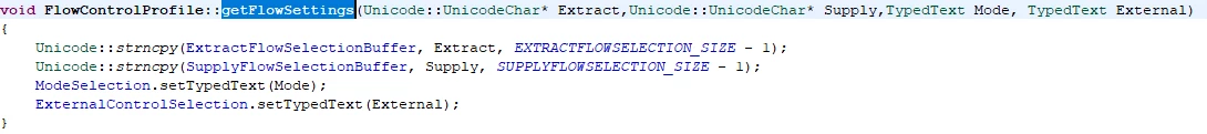

Hi I encountered with a problem. In model.hpp I have struct and how u see in buffer are these symbols '-':
0693W00000bhHczQAE.pngI take this buffer like this:
0693W00000bhHauQAE.pngAnd when values are updated:
0693W00000bhHdYQAU.png0693W00000bhHddQAE.png0693W00000bhHdnQAE.pngThe problem is that its not render correctly. Here needs to be "-- m3/h" but I got this
0693W00000bhHeRQAU.pngWhere is the problem?

Did you remember to add the - character to the wildcard character list for the typography you need it to appear in? (In the designer: Texts->Typographies->Wildcard Characters)
Embedded UI/UX Consulting: cadenza.design
