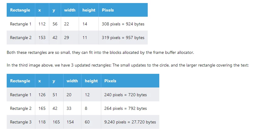

Referring to the website doc:
https://support.touchgfx.com/docs/development/scenarios/lowering-memory-usage-with-partial-framebuffer/#partial-frame-buffer-memory
Why is the bytes calculation: (Number of Pixels)* 3 ?

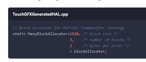

Earlier in the doc the ManyBlockAllocator is set up as 2 bytes per pixel.
In the same doc it also mentions having only 2 blocks but the example clearly shows 3.
"Here we are updating 3 rectangles, but the allocator only has 2 blocks. In that situation, TouchGFX will wait for the first blocks to transferred and then reuse the blocks."
Are these typos or am I missing something?
-> Where do you see this written ?
-> Indeed I agree this sentence is misleading. We'll try to modify it as soon as possible. What needs to be understood is that the third rectangle to be updated is too big so it will not fit into the last third block and will need also the first blocks to be completely updated. For this, TouchGFX will wait for the first blocks to be transferred and then reuse the blocks.
Refer to the table in the picture. Rectangle 1 has 308 pixels = 924 bytes.
In all cases the bytes are calculated as 3 times the number of pixels. Why?

Hello Guit32010,
Indeed it's a mistake since the article mentions using RGB565. So the bytes calculation should be (Number of Pixels)* 2 .
We'll fix this asap.
