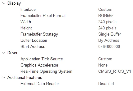

Hello!
I made the project for a custom SPI display with configuration like screenshot below:
Added in main.c:

And in TouchGFXHAL.cpp:
extern "C" void TouchGFX_TickHandler();
void TouchGFX_TickHandler() {
 OSWrappers::signalVSync();
The function TouchGFX_TickHandler() called one time and hangs on OSWrappers::signalVSync(). As a result (?) functions void TouchGFXHAL::flushFrameBuffer(const touchgfx::Rect& rect) and Screen1View::setupScreen() are never called.
I'm using the latest software (TouchGFX 4.16.1, latest HAL/CMSIS etc).
Is this a bug or am I missing an important detail?

I used this manual and STM32L496-DISCO Application template. Should I use only 1 call (OSWrappers::signalVSync or MX_TouchGFX_Process)? I used TouchGFX_TickHandler because display haven't got TE pin.
OSWrappers::waitForVsync() never returns.

Ok, I moved TouchGFX_TickHandler to HW timer TIM7_IRQHandler.
OSWrappers::signalVSync is called 2 times now. And TIM7_IRQHandler stop called. That is too strange.
void TouchGFXHAL::flushFrameBuffer(const touchgfx::Rect& rect) and Screen1View::setupScreen() are not called still. (((
