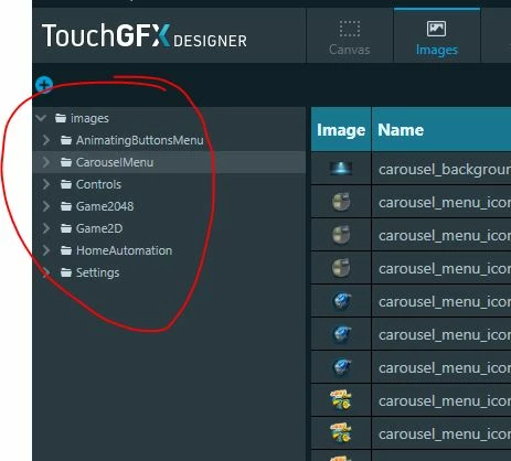

The Demo called "TouchGFX Demo2" has this folder organization.
I would like to realize this Folder organization:
0693W000007YzmvQAC.jpg How can I manage this organization on my project?

Hello MPast.1,
Simply create folders in assets/images folder and arrange your image accordingly.
The created folders will automatically appear in the Designer if png files are present inside.
/Alexandre
