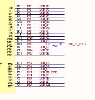

On wich pins are connected the LCD-TFT display of the STM32F746 discovery
I'm trying to configure the LTDC pheriferal manually but I can't find a schematic of table that tell wich pin of the STMF7 is connectet to a specific pin of the LCD screen. I looked on the STM32F746-DISCO user guide, but I don't find it.

in the cad files you should find, what you looking for:
https://www.st.com/en/evaluation-tools/32f746gdiscovery.html#cad-resources

Thank you so much!
