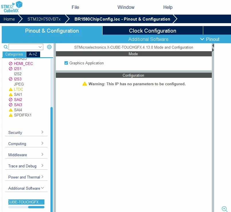

For some reason I am not seeing any configurable settings under the generator after getting it added to project.
